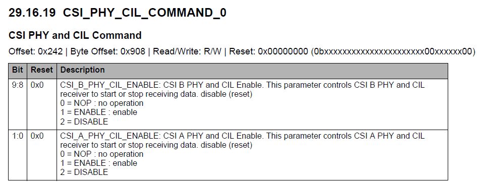

hello EV,
both yavta and v4l2-ctl would be useful tools to confirm the raw dump.
could you help check the CSI_PHY_CIL_COMMAND_0 register value while running this tools. please refer to the attachment.
you should able to use 3rdparty tool (devmem2) to read the register value.
thanks
I tried to read the CSI_PHY_CIL_COMMAND_0 register while running v4l2-ctl and here is the output.
Please check whether I am reading the right register. I found the CSI base address to be 0x54080000 and used the word offset 0x908 to read the register.
ubuntu@tegra-ubuntu:~/debug/devmem2$ sudo ./devmem2 0x54080908
/dev/mem opened.
Memory mapped at address 0x7f97840000.
Value at address 0x1409812744 (0x7f97840908): 0x1
hello EV,
seems your CSI_A_PHY_CIL was enabled correctly.
next step, could you please check the register value of CSI_CSI_CILA_STATUS_0.
attach the register description for your reference. thanks
