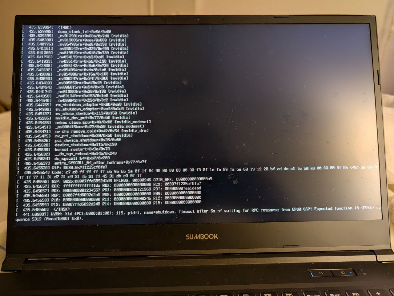

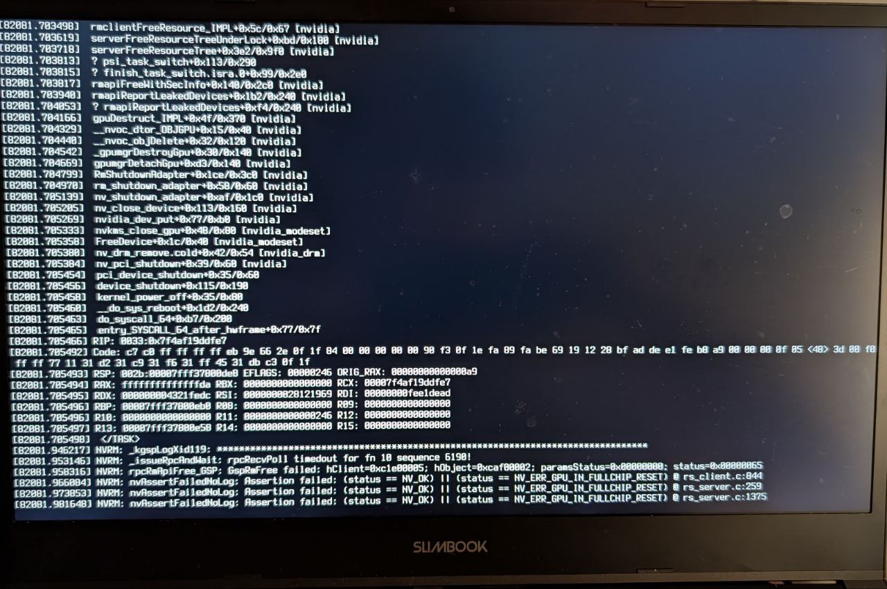

Kernel panic on shutdown on 580.105.08
I am running a NixOS-unstable host with an RTX 4060, kernel 6.12. PR NixOS/nixpkgs/#457894, which includes the upgrade for x86_64 from 580.95.05 to 580.105.08 for users on the “production” branch (which I am on) (see pkgs/os-specific/linux/nvidia-x11/default.nix) lead to issues both on the open kernel module variant and non-open kernel module driver. I am yet to check that 580.95.05 non-open was unaffected by this issue before this version.
My configuration is available at github LucasFA/.nixos (can’t link)
The following are transcribed images through Google Lens, pictures at the bottom.
Non-open kernel module driver dump:
[435.639893] Hardware name: SLIMBOOK HERO-RPL-RTX/HERO-RPL-RTX, BIOS N.1.0360584 82/82/2824

SLIMBOOK
open_kernel_dump.txt (4.6 KB)
Pictures
Open kernel module:
(Part 1 omitted because of new user media posting restrictions)
Non open kernel module:
Link to the open kernel modules bug report: Kernel panic on shutdown, rmapiReportLeakedDevices · Issue #970 · NVIDIA/open-gpu-kernel-modules · GitHub
