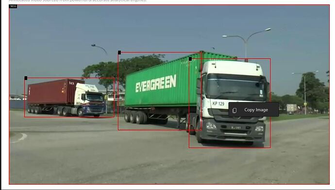

im following the python version of LPR
but im getting 2 bounding box , on the outer box im getting the licence plate number , how to match with the primary bounding box

You can get the parent object from the SGIE output. NVIDIA DeepStream SDK API Reference: _NvDsObjectMeta Struct Reference
does the licence number would be drawn within the bounding box ?
Yes. Nvidia LPR c/c++ sample will show license string in bbox.

im getting lpd as the detection , not getting the licence plate value of it
i need to make bounding box co-ordinates to 0,0,0,0 in the config of sgie , how to do it , do that outer bouding box gets erased and pushed at Licence plate
@h9945394143 Please use our LPR sample. It can display the car license and we set the text in yellow color.
The python sample is not provided by Nvidia. Please ask the author for help.
