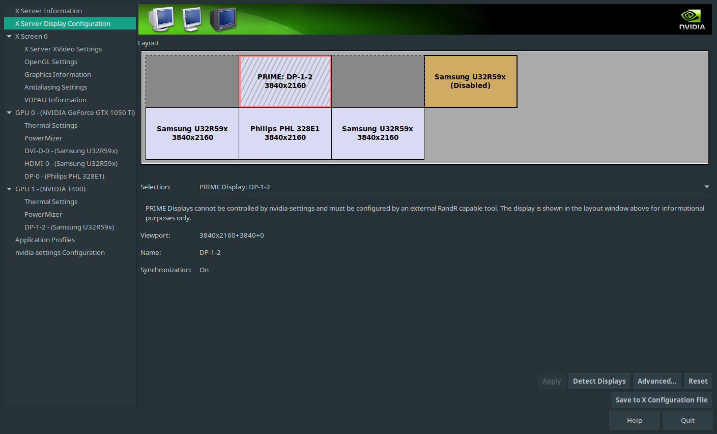

Manjaro Linux, trouble creating additional XScreen
There are numerous topics everywhere on the internet including manjaro forums and superuser stackexchange and so far none of the solutions provided work.
I have four monitors and two GPUs (1050ti and t400 quadro), and on the first one there are 3 monitors connected, and on the t400 there is additional 4th monitor connected.
The nvidia-settings utility does detect both GPUs without problems, as well as all 4 monitors. Also it is obvious that the monitor is working since it is led up and reacting to the events in the system, such as booting up:
Well when I try to enable 4th screen it gives the only option to create additional XScreen. Then also it asks to save the config and I do just that by also enabling Xinerama since I think it should be enabled anyway, and save it. And I tried to save it to multiple locations, including the default one, but I believe it uses /etc/X11/mhwd.d/nvidia.conf since before only updating that file made any effect.
Anyway. Here is the content of Xorg.0.log file:

[     9.242] (--) NVIDIA(GPU-1): DFP-0: disconnected
[     9.242] (--) NVIDIA(GPU-1): DFP-0: Internal DisplayPort
[     9.242] (--) NVIDIA(GPU-1): DFP-0: 2660.0 MHz maximum pixel clock
[     9.242] (--) NVIDIA(GPU-1): DFP-1: disconnected
[     9.242] (--) NVIDIA(GPU-1): DFP-1: Internal TMDS
[     9.242] (--) NVIDIA(GPU-1): DFP-1: 165.0 MHz maximum pixel clock
[     9.242] (--) NVIDIA(GPU-1): Samsung U32R59x (DFP-2): connected
[     9.242] (--) NVIDIA(GPU-1): Samsung U32R59x (DFP-2): Internal DisplayPort
[     9.242] (--) NVIDIA(GPU-1): Samsung U32R59x (DFP-2): 2660.0 MHz maximum pixel clock
[     9.244] (--) NVIDIA(GPU-1): DFP-3: disconnected
[     9.244] (--) NVIDIA(GPU-1): DFP-3: Internal TMDS
[     9.244] (--) NVIDIA(GPU-1): DFP-3: 165.0 MHz maximum pixel clock
[     9.244] (--) NVIDIA(GPU-1): DFP-4: disconnected
[     9.244] (--) NVIDIA(GPU-1): DFP-4: Internal DisplayPort
[     9.244] (--) NVIDIA(GPU-1): DFP-4: 2660.0 MHz maximum pixel clock
[     9.245] (--) NVIDIA(GPU-1): DFP-5: disconnected
[     9.245] (--) NVIDIA(GPU-1): DFP-5: Internal TMDS
[     9.245] (--) NVIDIA(GPU-1): DFP-5: 165.0 MHz maximum pixel clock
[     9.285] (WW) NVIDIA(G0): No valid modes for
[     9.285] (WW) NVIDIA(G0):     "DP-0:nvidia-auto-select+3840+0,DVI-D-0:nvidia-auto-select+7680+0,HDMI-0:nvidia-auto-select+0+0";
[     9.285] (WW) NVIDIA(G0):     removing.
[     9.285] (WW) NVIDIA(G0): Unable to validate any modes; falling back to the default mode
[     9.285] (WW) NVIDIA(G0):     "nvidia-auto-select".
[     9.286] (II) NVIDIA(G0): Validated MetaModes:
[     9.286] (II) NVIDIA(G0):     "DFP-2:nvidia-auto-select"
[     9.286] (II) NVIDIA(G0): Virtual screen size determined to be 3840 x 2160
[     9.333] (--) NVIDIA(G0): DPI set to (139, 140); computed from "UseEdidDpi" X config
[     9.333] (--) NVIDIA(G0):     option
[     9.334] (II) NVIDIA: Reserving 24576.00 MB of virtual memory for indirect memory
[     9.334] (II) NVIDIA:     access.
[     9.335] (II) NVIDIA(0): ACPI: failed to connect to the ACPI event daemon; the daemon
[     9.335] (II) NVIDIA(0):     may not be running or the "AcpidSocketPath" X
[     9.335] (II) NVIDIA(0):     configuration option may not be set correctly.  When the
[     9.335] (II) NVIDIA(0):     ACPI event daemon is available, the NVIDIA X driver will
[     9.335] (II) NVIDIA(0):     try to use it to receive ACPI event notifications.  For
[     9.335] (II) NVIDIA(0):     details, please see the "ConnectToAcpid" and
[     9.335] (II) NVIDIA(0):     "AcpidSocketPath" X configuration options in Appendix B: X
[     9.335] (II) NVIDIA(0):     Config Options in the README.
[     9.350] (II) NVIDIA(0): Setting mode "DP-0:nvidia-auto-select+3840+0,DVI-D-0:nvidia-auto-select+7680+0,HDMI-0:nvidia-auto-select+0+0"
[     9.474] (==) NVIDIA(0): Disabling shared memory pixmaps
[     9.474] (==) NVIDIA(0): Backing store enabled
[     9.474] (==) NVIDIA(0): Silken mouse enabled
[     9.474] (**) NVIDIA(0): DPMS enabled
[     9.475] (II) Loading sub module "dri2"
[     9.475] (II) LoadModule: "dri2"
[     9.475] (II) Module "dri2" already built-in
[     9.475] (II) NVIDIA(0): [DRI2] Setup complete
[     9.475] (II) NVIDIA(0): [DRI2]   VDPAU driver: nvidia
[     9.478] (II) NVIDIA(G0): ACPI: failed to connect to the ACPI event daemon; the daemon
[     9.478] (II) NVIDIA(G0):     may not be running or the "AcpidSocketPath" X
[     9.478] (II) NVIDIA(G0):     configuration option may not be set correctly.  When the
[     9.478] (II) NVIDIA(G0):     ACPI event daemon is available, the NVIDIA X driver will
[     9.478] (II) NVIDIA(G0):     try to use it to receive ACPI event notifications.  For
[     9.478] (II) NVIDIA(G0):     details, please see the "ConnectToAcpid" and
[     9.478] (II) NVIDIA(G0):     "AcpidSocketPath" X configuration options in Appendix B: X
[     9.478] (II) NVIDIA(G0):     Config Options in the README.
[     9.492] (II) NVIDIA(G0): Setting mode "DFP-2:nvidia-auto-select"
[     9.610] (==) NVIDIA(G0): Disabling shared memory pixmaps
[     9.610] (==) NVIDIA(G0): Backing store enabled
[     9.610] (==) NVIDIA(G0): Silken mouse enabled
[     9.610] (**) NVIDIA(G0): DPMS enabled
[     9.610] (II) Loading sub module "dri2"
[     9.610] (II) LoadModule: "dri2"
[     9.610] (II) Module "dri2" already built-in
[     9.610] (II) NVIDIA(G0): [DRI2] Setup complete
[     9.610] (II) NVIDIA(G0): [DRI2]   VDPAU driver: nvidia
[     9.610] (II) Initializing extension Generic Event Extension
[     9.610] (II) Initializing extension SHAPE
[     9.610] (II) Initializing extension MIT-SHM
[     9.610] (II) Initializing extension XInputExtension
[     9.610] (II) Initializing extension XTEST
[     9.610] (II) Initializing extension BIG-REQUESTS
[     9.610] (II) Initializing extension SYNC
[     9.610] (II) Initializing extension XKEYBOARD
[     9.611] (II) Initializing extension XC-MISC
[     9.611] (II) Initializing extension SECURITY
[     9.611] (II) Initializing extension XFIXES
[     9.611] (II) Initializing extension RENDER
[     9.611] (II) Initializing extension RANDR
[     9.611] (II) Initializing extension COMPOSITE
[     9.611] (II) Initializing extension DAMAGE
[     9.611] (II) Initializing extension MIT-SCREEN-SAVER
[     9.611] (II) Initializing extension DOUBLE-BUFFER
[     9.611] (II) Initializing extension RECORD
[     9.611] (II) Initializing extension DPMS
[     9.611] (II) Initializing extension Present
[     9.611] (II) Initializing extension DRI3
[     9.611] (II) Initializing extension X-Resource
[     9.611] (II) Initializing extension XVideo
[     9.611] (II) Initializing extension XVideo-MotionCompensation
[     9.611] (II) Initializing extension GLX
[     9.612] (II) Initializing extension GLX
[     9.612] (II) Indirect GLX disabled.
[     9.612] (II) GLX: Another vendor is already registered for screen 0
[     9.612] (II) Initializing extension XFree86-VidModeExtension
[     9.612] (II) Initializing extension XFree86-DGA
[     9.612] (II) Initializing extension XFree86-DRI
[     9.612] (II) Initializing extension DRI2
[     9.612] (II) Initializing extension NV-GLX
[     9.612] (II) Initializing extension NV-CONTROL
[     9.612] (II) Initializing extension XINERAMA

And here is the content of xorg.conf file nvidia-settings utility generates:
# nvidia-settings: X configuration file generated by nvidia-settings
# nvidia-settings:  version 495.44
Section "ServerLayout"
    Identifier     "Layout0"
    Screen      0  "Screen0" 0 0
    Screen      1  "Screen1" RightOf "Screen0"
    InputDevice    "Keyboard0" "CoreKeyboard"
    InputDevice    "Mouse0" "CorePointer"
    Option         "Xinerama" "1"
EndSection
Section "Files"
EndSection
Section "InputDevice"
    # generated from default
    Identifier     "Mouse0"
    Driver         "mouse"
    Option         "Protocol" "auto"
    Option         "Device" "/dev/psaux"
    Option         "Emulate3Buttons" "no"
    Option         "ZAxisMapping" "4 5"
EndSection
    Identifier     "Keyboard0"
    Driver         "kbd"
EndSection
Section "Monitor"
    # HorizSync source: edid, VertRefresh source: edid
    Identifier     "Monitor0"
    VendorName     "Unknown"
    ModelName      "Philips PHL 328E1"
    HorizSync       160.0 - 160.0
    VertRefresh     48.0 - 60.0
    Option         "DPMS"
EndSection
Section "Monitor"
    Identifier     "Monitor1"
    ModelName      "Samsung U32R59x"
    HorizSync       30.0 - 135.0
    VertRefresh     30.0 - 75.0
    Option         "DPMS"
EndSection
Section "Device"
    Identifier     "Device0"
    Driver         "nvidia"
    VendorName     "NVIDIA Corporation"
    BoardName      "NVIDIA GeForce GTX 1050 Ti"
    BusID          "PCI:1:0:0"
EndSection
Section "Device"
    Identifier     "Device1"
    Driver         "nvidia"
    BoardName      "NVIDIA T400"
    BusID          "PCI:4:0:0"
EndSection
Section "Screen"
    Identifier     "Screen0"
    Device         "Device0"
    Monitor        "Monitor0"
    DefaultDepth    24
    Option         "Stereo" "0"
    Option         "nvidiaXineramaInfoOrder" "DFP-2"
    Option         "metamodes" "DP-0: nvidia-auto-select +3840+0, DVI-D-0: nvidia-auto-select +7680+0, HDMI-0: nvidia-auto-select +0+0"
    Option         "SLI" "Off"
    Option         "MultiGPU" "Off"
    Option         "BaseMosaic" "off"
    SubSection     "Display"
        Depth       24
    EndSubSection
EndSection
Section "Screen"
    Identifier     "Screen1"
    Device         "Device1"
    Monitor        "Monitor1"
    DefaultDepth    24
    Option         "Stereo" "0"
    Option         "metamodes" "nvidia-auto-select +0+0 {AllowGSYNC=Off}"
    Option         "SLI" "Off"
        Depth       24
    EndSubSection
EndSection
Also tried to manually edit the file, including changing the MultiGPU option with no effect.

Holy sh!t!!! It works!!! Finally.
But!!! It does create some abnormalities, like this one:
And I believe those abnormalities foreshadow the problems yet to come when I’ll continue adding monitors (planning to get 6*4k displays).
I must point that out because nvidia devs must be aware of this and also it’d be perfect if such scaling were supported by a nvidia drivers.
But anyway, thank you for help, @generix and if you want, you can send me a paypal in DM, if this forum supports it, so I could “buy you a cup of coffee”.
That’s normal, the 4th monitor is added using PRIME functionality, so nvidia settings always says “prime display”
My advice: don’t do that. If you want a monitor to display more than just the desktop background, you’ll need about 1.3GB video memory per 4k monitor (FHD:350MB) on the primary graphics card, with three enabled monitors, you were at 3.1GB/4GB already. if you run out of VMEM, the gpu will start using system memory and everything will come down to a crawl. I guess you will already notice slowdowns now, depending on the amount of applications you’re starting.
The nvidia way would be using “Mosaic” which is limited to pairs of identical gpus, mostly Quadro type.
The nvidia2nvidia prime functionality was just added in driver 470.
