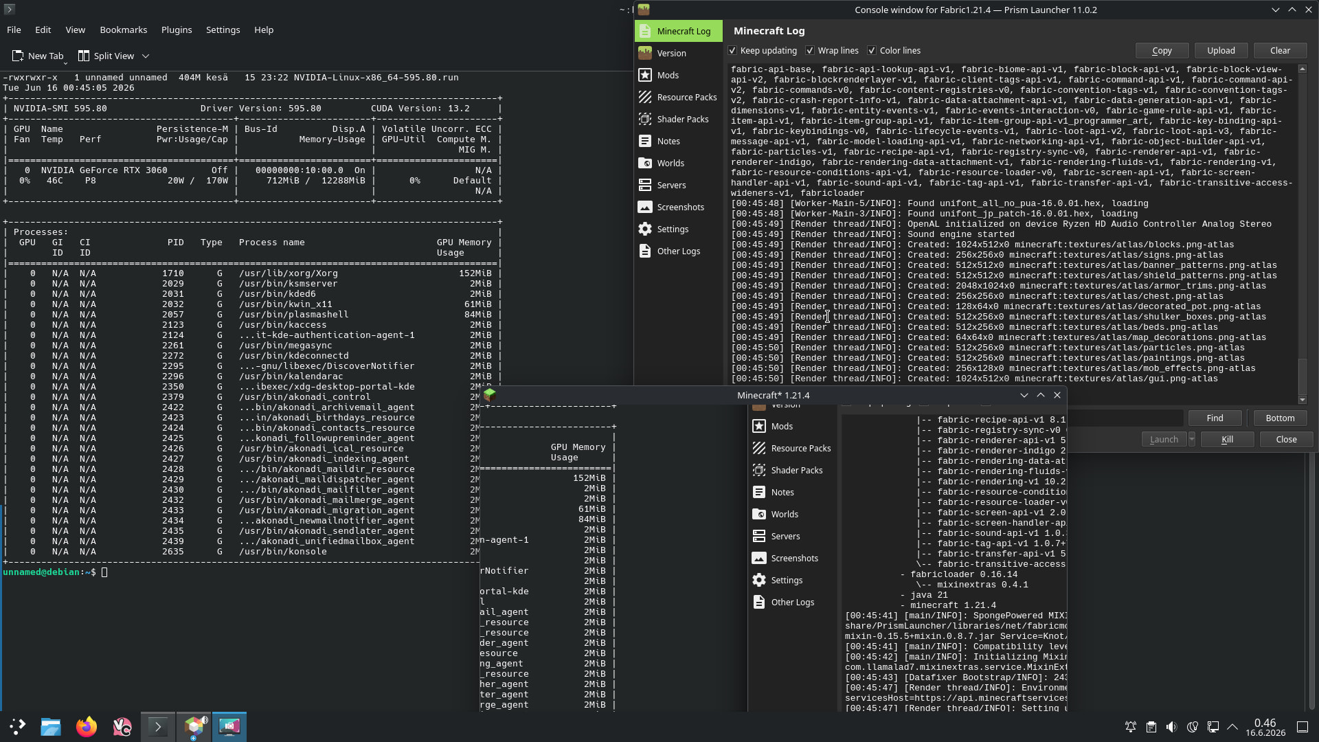

Minecraft Java not rendering (Regression since 595 drivers)
OS: Debian 13 (Trixie)
GPU: RTX 3060 LHR
CPU: AMD Ryzen 5 5500
Mobo: MSI B450 Gaming Plus Max
Launcher Used: Prism Launcher AppImage (But should be replicateable with the official java launcher)
Driver version 580.159.04 (Tue May 19, 2026) is the last version where minecraft java edition renders and works correctly, whereas anything newer (595.58.03 - 595.80) just breaks it. Other games and software work fine for me with what i use/play whereas seemingly only minecraft breaks. As far as i’m aware, this is the same for both the individual .run packages and nvidia apt repo drivers.
Module used: Nvidia Proprietary (Should also happen with MIT/GPL)
32-bit compatibility libs: Installed
DKMS: Enabled
Rebuilt initramfs during install: Yes
I’ve attached both bug reports following the guide linked here.
Edit 1: Also added images of the issue.
