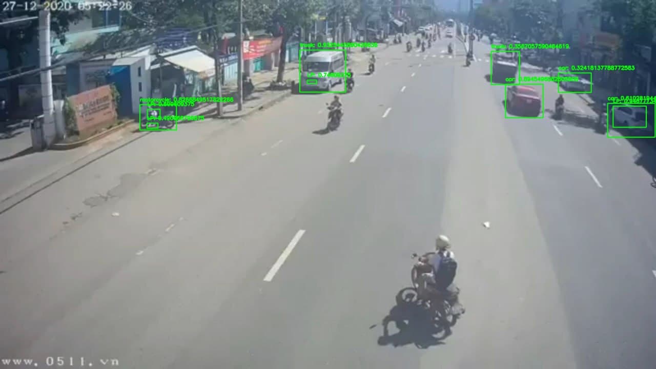

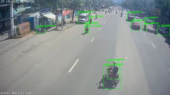

When using tracking NvDCF, the results is better than Deepsort tracking, frame miss object when using pgie:
When using NvDCF:

Using Deepsort with your weight in Gst-nvtracker — DeepStream documentation

**How to change the parameter for not miss object detection
Please upgrade to the latest DeepStream 7.1. Our recommendation is use NvDCF tracker. Why NvDCF isn’t the best option for your project?
My project is mainly designed for crowded places such as cafes and streets, so the tracker often loses the object or switches tracking to another one. Could you please help me adjust the necessary parameters in the NvDCF config to improve this?
Here is the comparison of NvDCF config: Gst-nvtracker — DeepStream documentation . Can you have a try with: config_tracker_NvDCF_accuracy.yml. Here is the tracking accuracy with PepeleNet+NvDCF: Gst-nvtracker — DeepStream documentation . Please test it with the latest DeepStream release.
