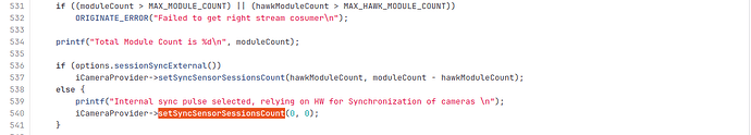

I am trying to implement the single capture session for dual sensors of a stereo camera. I saw in the syncStereo sample, there’s the following code snippet :
As I do not have a Hawk stereo camera to test with, I would like to know to use correctly/how to pass correct arguments to the setSyncSensorSessionsCount() method, please ?
Concretely, for our system with a single stereo camera having dual sensors, what values should I give to the dualSensors and singleSensor of the setSyncSensorSessionsCount() API? Especially what happens with value 0?

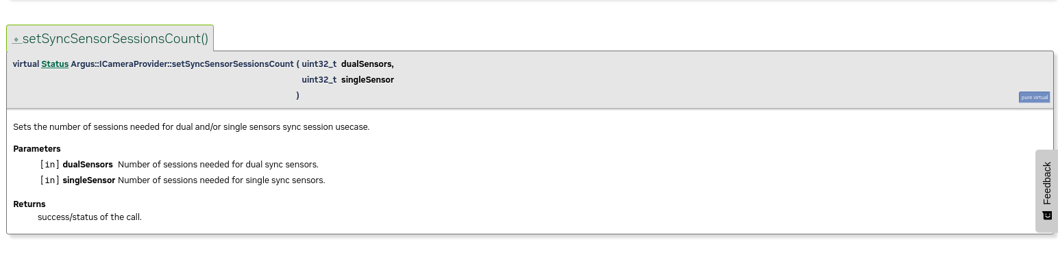

Here is the details as per public header:
     * Sets the number of sessions needed for dual and/or single sensors sync session usecase.
     * @param[in] dualSensors Number of sessions needed for dual sync sensors.
     * @param[in] singleSensor Number of sessions needed for single sync sensors.
     * @returns success/status of the call.
    virtual Status setSyncSensorSessionsCount(uint32_t dualSensors, uint32_t singleSensor) = 0;
Here dualSensors  means they will be running in sync as a stereo pair, in your case only single stereo pair need to be executed in sync so dualSensors should 1.
As singleSensor meant for mono cameras that are not part of stereo sync pair, in your case no camera is there as mono so singleSensor should 0.

This API is base on the sensor have HW sync design like GMSL F-SYNC if your HW don’t have the HW support that couldn’t sync the frame correctly.
