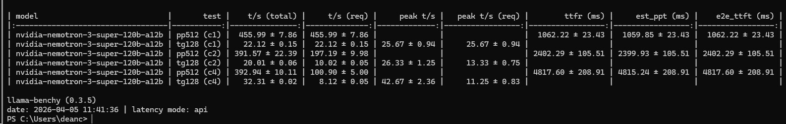

After wasting my life f**king around with special vLLM containers and NVFP4 Nvidia files made with H100s in mind, i’ve found the super secret way to get 20-22 tok/s with Nemotron-3-Super-120B on a single DGX Spark (ASUS GX10 in my case).
Drum roll…
Just put LM Studio on your DGX and run a GGUF model. Yes, that’s right - running unsloth/NVIDIA-Nemotron-3-Super-120B-A12B-GGUF · Hugging Face at Q4_K_M with KV Q8_0. Faster model load, simple interface, no issues - it just works. I’m not wasting my time with vLLM anymore.
Or enable MTP.
I’m getting actual rates of 19-20 tok/s just from the community Docker vLLM with MTP.
You can also use the LMStudio Server to connect your LLMs to other tools, even across your network.
Came across this solution two weeks ago. My spark is at the moment 5000km away from me and it just works …..
I’m not giving up on vllm though 😃 … not yet

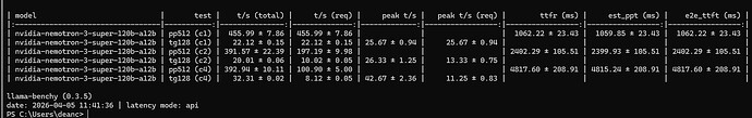

llama-benchy results:
I actually was tuning it for weeks, finding proper images to run it, to avoid OOM (always on 0.21+ due to cudagraph profiler exploding), in the end it was pretty good

After 12 hours today got pretty much same config running on cluster (no-ray), had to build a custom image off 0.20 version. But results are more than I expected.
