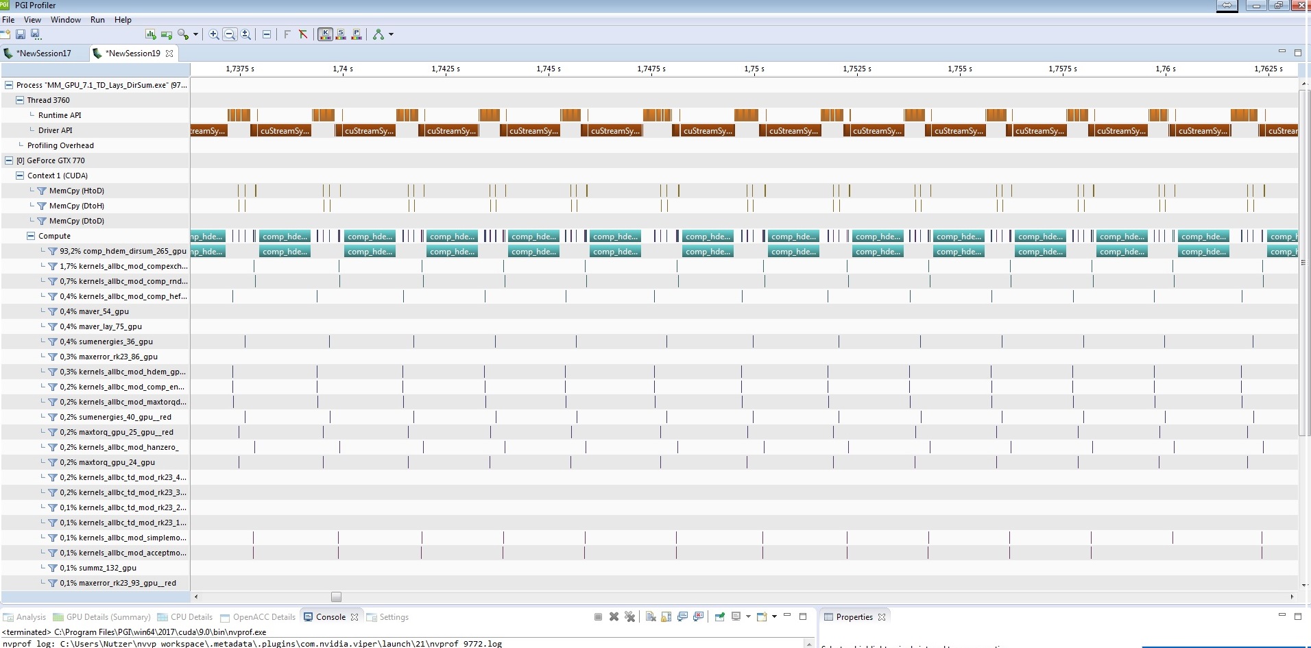

  1. Concerning profiling:
I made a profiling of my code. Please find the output under:
and zoomed ones
It seems that there is no data movement between host and device during the kernel calculation (subroutine comp_hdem_dirsum). Is this correct?
(My program calls many times this kernel). It takes about 93% computation time.
That looks correct to me. There is some data movement but it looks to be after your compute regions with reductions.
