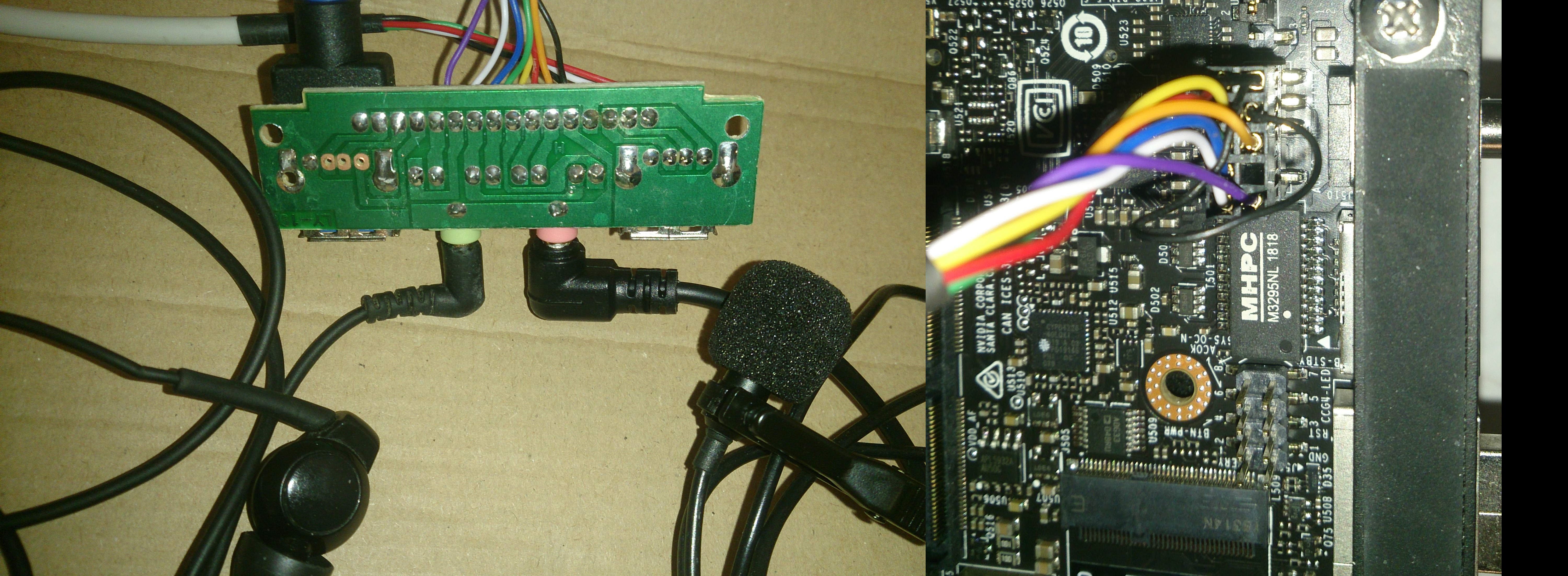

Hi bought this audio header panel.
External Media
But, I do not observe microphone/headphone working in ubuntu sound window!
External Media
Jetpack 4.1.1 L4T 31.1.0
Output from ‘dmesg’https://www.codepile.net/pile/m1eR07Yr

I think I am missing something somewhere. Could you suggest me any troubleshoot?
I have already performed the connectivity check of the panel I bought.
My findings are:
External Media
Hello!
If you connect headphones or a microphone to the jacks, can you see if the codec is detecting this by executing the following command?
$ amixer -c tegrasndt19xmob cget name="x Jack-state"
numid=1238,iface=MIXER,name='x Jack-state'
; type=ENUMERATED,access=rw------,values=1,items=4
; Item #0 'None'
; Item #1 'HP'
; Item #2 'MIC'
; Item #3 'HS'
: values=0
The ‘values’ should be set to ‘HP’ if only headphones are connected, ‘MIC’ if only microphone is connected and ‘HS’ (for headset) is both headphones and microphone are connected.
Also can you try executing the following to make sure the codec is correctly configured …
$ alsactl init tegrasndt19xmob
If it is still not working, do you have a desktop PC with a HD audio connector (unfortunately this is probably inside the case) that you can connect this to and ensure that this HD audio connector is good?

Thanks @jonathanh
I performed
And then I checked with
Suddenly, audio started working. I think alsactl command did some initialization. Or, I dont know.
But, Now audio is working. Thanks again.
