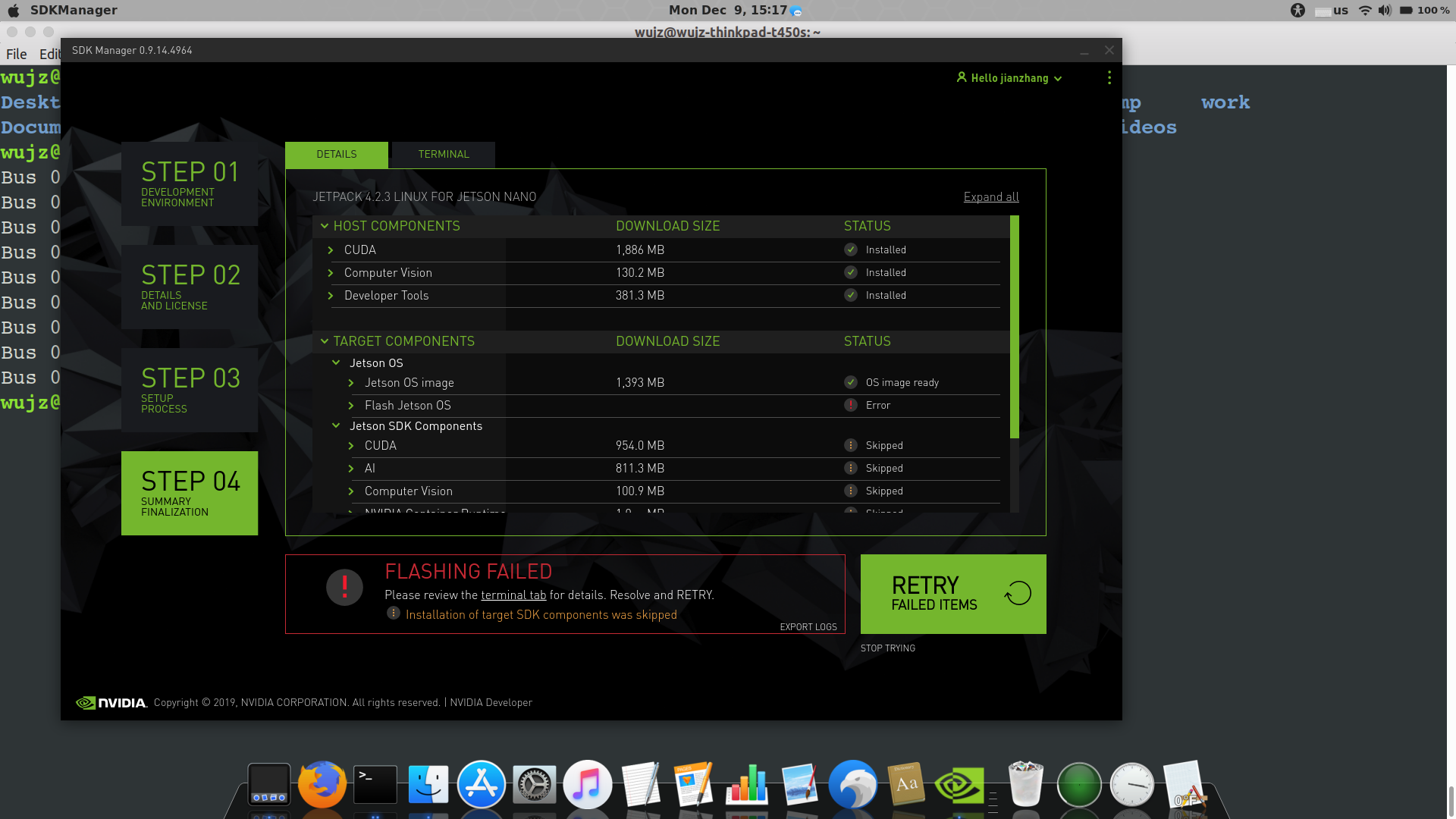

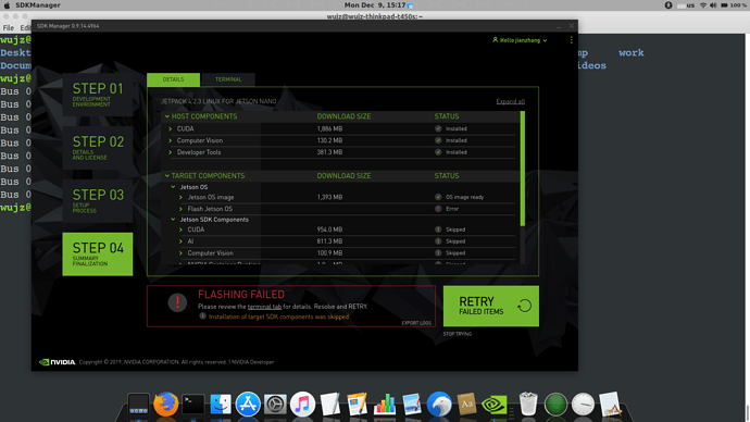

Nvidia Jetson Nano flashing emmc fail issue
I have a nano module with eMMC and now I have some problem when flashed this module with sdkmanager.
The version of the sdkmanager is 0.9.14-4964_amd64.deb
The version of the Jetpack is JetPack_4.2.3_Linux_GA_P3448-0020
The logs from file “NV_L4T_FLASH_NANO_WITH_OS_IMAGE_COMP.log” are as follows:

Error: Return value 1
Command tegrarcm --download ebt cboot.bin.encrypt 0 0 --download rp1 tegra210-p3448-0002-p3449-0000-b00.dtb.encrypt 0
Failed flashing t210ref.
Info: [ Component Install Finished with Error ]
Info: [ 8.16 GB used. Disk Avail: 90.03 GB ]
Info: [ NV_L4T_FLASH_NANO_WITH_OS_IMAGE_COMP Install took 1m34s ]
Error: Run commands failed at step Install: command sudo ./flash.sh jetson-nano-emmc mmcblk0p1 finished with error
SDKM_logs_JetPack_4.2.3_Linux_for_Jetson_Nano_2019-12-09_15-15-54.zip (524 KB)
The logs from the serial port when flashing the module are as follows:

[0228.591] DebugPort= 0x3
[0228.604] NvTbootI2cWaitForTransferComplete(): error code 0x00000005 I2C Transaction could not complete within time
[0228.625] NvTbootI2cWaitForTransferComplete(): error code 0x00000005 I2C Transaction could not complete within time
[0228.635] NvTbootI2cWrite(): error code 0x00000005 Error while starting write transaction
[0228.642] NvTbootI2cDeviceRead(): error code 0x00045001 Error while sending the offset to slave
[0228.651] NvTbootI2c: Read failed for slave 0xac, offset 0x00 with error code 0x00045001
[0228.659] Reading Board-Type unsuccessful
[0228.663] BoardId read from EEPROM/NCT: 0
[0228.666] Unsupported Platform 0
[0228.669] Downloaded BCT successfully
The screenshot picture of the sdkmanager when problem occurred is in the attachment
