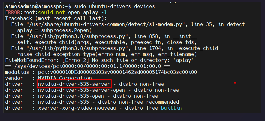

The output of ubuntu-drivers devices is:
So I’ve try to install the correct drivers use
But I couldn’t solve it.
Please tell me how to solve it
nvidia-bug-report.log.gz (132.1 KB)
Both gpus error out:
[ 128.576226] NVRM: GPU 0000:01:00.0: RmInitAdapter failed! (0x25:0x40:1468)
[ 128.576289] NVRM: GPU 0000:01:00.0: rm_init_adapter failed, device minor number 0
[ 132.594480] NVRM: GPU 0000:01:00.0: RmInitAdapter failed! (0x23:0x65:1426)
[ 132.594552] NVRM: GPU 0000:01:00.0: rm_init_adapter failed, device minor number 0
[ 133.119189] NVRM: GPU 0000:03:00.0: RmInitAdapter failed! (0x25:0x40:1468)
[ 133.119255] NVRM: GPU 0000:03:00.0: rm_init_adapter failed, device minor number 1
[ 137.137709] NVRM: GPU 0000:03:00.0: RmInitAdapter failed! (0x23:0x65:1426)
[ 137.137783] NVRM: GPU 0000:03:00.0: rm_init_adapter failed, device minor number 1
Please check for a bios update. It might be worth a shot to try upgrading to driver 550 and/or using the nvidia-open driver.
