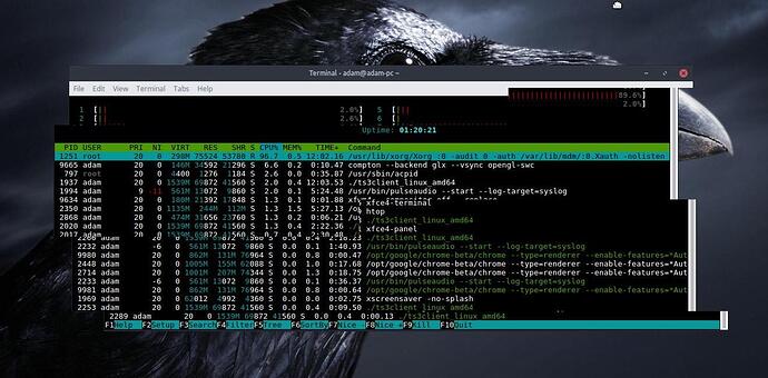

Problem: When dragging windows around or resizing them, CPU usage spikes to 100%. With certain combinations of compositor vsync and Nvidia sync to vblanks, it can be fixed… but doing this forces you to deal with tearing on the desktop.

Here is a screenshot taken while actively dragging a window around, you can see the spike.
