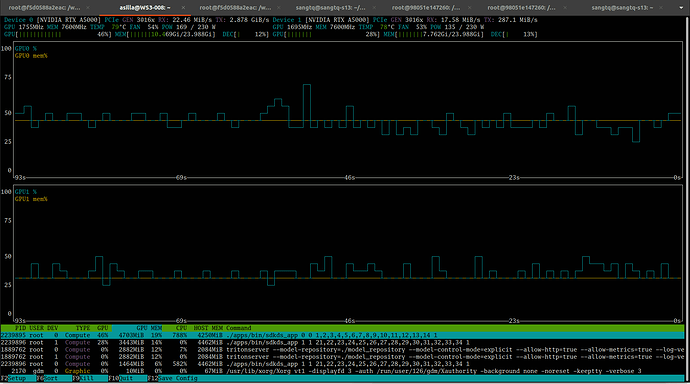

NvInfer using both GPU 0 and GPU 1 although setting gpu-id = 1
I have a project with 2 deepstream pipeline app. The first app will run on GPU 0 and the second one will run on GPU 1. My expectation is that 2 app will run separately in each GPU to have best performance for each app. However, when I see the monitor with nvtop, I see that app 1 run on both GPU 0 and GPU 1 although I set the gpu-id for nvinfer plugin when creating in the pipeline. If I disable NvInfer, 2 app will run separately with each other. I attached nvinfer config file and nvtop display image in the attachment. So my question is do I have problem with setting NvInfer or this plugin always have a part running on GPU 0 by default?

@Fiona.Chen I alreadly set up gpu-id for each app with 0, 1 respectively. I also used NVIDIA_VISIBLE_DEVICES before running the app, the issue is the same. When I disable nvinfer and just run previous components in the pipiline, the issue is disappeared. So I think there is one part of nvinfer using GPU 0 by default, is it right?
You just post the configuration of gst-nvinfer. What is your setting in your app?
If you use NVIDIA_VISIBLE_DEVICES, you don’t need to set “gpu-id” value in the app or gst-nvinfer configuration.
This is our pipeline. For other component, I also set gpu-id for each of them. I think the problem comes from nvinfer because If I disable nvinfer, I see 2 deepstream app run in 2 separated gpu 0 and 1 respectively.
I found the problem coming from the function gst_nvdspreprocess_output_loop of nvdspreprocess plugin. I need to set the cuda device for this thread and the problem disappeared but I still wonder how it afftect to system performance?By the way, I also have other question about how to calculate maximum number of cameras that the pipeline can run in parallel and how to configure pipeline to get max performance?. For the case I use nvpreprocess for 20 cameras with 3 rois, what is the most suitable batch-size to set for streammux and nvinfer to get max performance?

The picture is too small to be clear.
