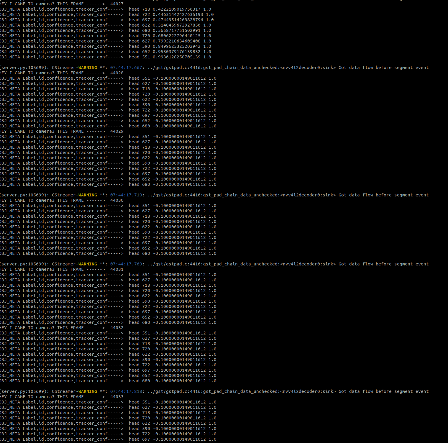

Let me explain you the scenario properly,I have a infer model (person-model given by the nvidia detector), inside infer.txt file “interval= 3” is given.After infer we have tracker.
When we are printing obj_meta.confidence
it should call infer after 3 frames right ?
I am attaching the scream shot to you to understand it properly
Can you tell me what is the problem ?

How you check this? Are you add probe at the src pad of nvinfer? nvinfer is open source plugin. You can add log to conform the behavior. Please use NvDCF tracker when you set PGIE inference interval.
Hi @kesong

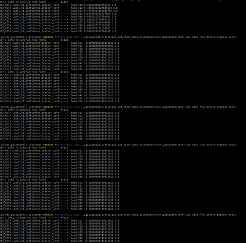

We are taking pad from “fakesink” added pad probe callback, there I am printing
print(f"label------------------------------------------> ",obj_meta.obj_label,obj_meta.object_id,obj_meta.confidence)
As our interval is 3 we are suspecting next 4th frame it will detect and obj will get the confidence >0. That’s what we shown you above picture ! We are using NVDCF tracker,tried with three different *.yml performance ,accuracy and pref.We are not saying it’s infer issue the inconsistency may be rooted innvinfer or its coordination with the tracker module.
We are requesting you to replicate the issue, get back to us ASAP ?
Can you have a try to add pad probe at the src pad of nvinfer? So you can check which plugin cause the unexpect result.
