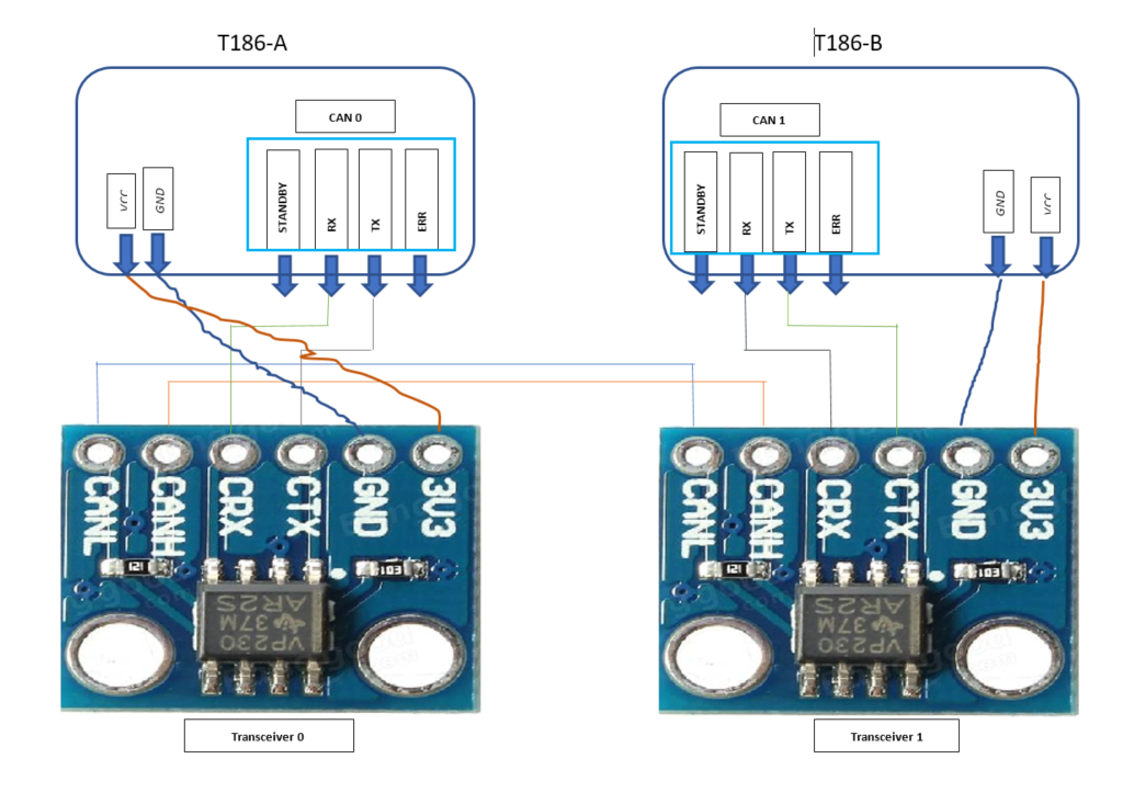

As the TX2 dev board has a CAN bus interface now I’m wondering what the best interface for my BMW (OBD) would be to get things like steering angles,…
Thanks for any input

I’m interested in this information as well. I see that 9 pins on the second GPIO are dedicated for two CAN bus networks (HS/MS).
Is there a C/C++ library available for the CAN interface?
Will we be able to just rig up the 9 pins to a ODB2-DB9 cable adapter, set the baud rate, and listen/transmit on the networks?
A CAN node consists of a CAN Controller and a transceiver.
Controller and transceiver together implements the full protocol stack.
TX2 has support of 2 CAN controllers as part of SoC.
Hence we will need to have CAN transceivers to do a full set-up for CAN communication.
These are pin descriptions for both the CAN controllers on Jetson-TX2.

For a minimal setup CAN transmission,
only CAN_TX and CAN_RX pins of Tegra CAN controller has to be configured with CAN transceiver.
Please check the attachments for connection specification.
Hope this helps.

Rather than messing with the TX2’s onboard CAN (you’ll likely need a CAN transceiver such as an SN65HVD230 for use with the TX2) you might want to get started with a USB-to-CAN adapter - I’ve had very good results with a Canable interfacing with a 2006 Sienna and a 2009 Outback - http://canable.io/

I’m not sure about the Tegra/TX2 - but just like many SoCs don’t have onboard PHYs for Ethernet (only a MAC), most microcontrollers have the rough equivalent of CAN MAC logic onboard but do not include a PHY - because there are actually at least two CAN bus standards out there. There’s the typical (very common) two-wire high-speed CAN, and there’s also a single-wire fault-tolerant low-speed CAN standard used in some vehicles (I’ve never worked with that form of CAN before).
