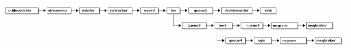

questions
Just wondering what is the best/optimum way of doing this C++ deepstream application. I have got the first and second dataflow working without any issue, I am wondering if the third dataflow consists of sgie to a message broker is an optimum solution. The sgie I am using probe to skip, filter on particular stream, filter on objects before sending a custom message to my python app. I am communicating to my python app using zmq via the msgbroker (Pub/Sub). The dsvideowriter is a custom module based on dsexample. The whole application works with the first two dataflows talking to my python app. I just need to add this custom sgie and I can’t think of a optimum way of doing this.
Cheers
Paul
decided to create a custom nvinfer to simplify pipeline
