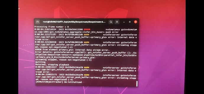

When I modify my configuration file in sink 0 from 0 to 1, I get this error:
ERROR: nvdemetamux gstnvdsmetamux.cpp:1005: gst_nvdsmeatmux_aggregate:<infer_bin_muxer> push error
How do you run the docker , can you share the command line ?
And what the model of your GPU ?
Yeah, I’m running the docker, and DS version is 6.3, the command is:
./apps/deepstream-parallel-infer/deepstream-parallel-infer -c configs/apps/bodypose_yolo_lpr/source4_1080p_dec_parallel_infer.yml
It’s the demo of the repo deepstream_parallel_inference_app offered.
And the error ocurrred when I modify the sink:0 (enalbe: 0 → 1)
I mean how do you start docker.
If you want to display in docker, you need to follow the following steps
xhost +
docker run --gpus all -it --rm --net=host --privileged -v /tmp/.X11-unix:/tmp/.X11-unix -e DISPLAY=$DISPLAY -w /opt/nvidia/deepstream/deepstream-6.3 nvcr.io/nvidia/deepstream:6.3-triton-multiarch

I start docker with command as follows:
docker run -it --gpus all nvcr.io/nvidia/deepstream:6.3-triton-multiarch /bin/bash
So, do I need to start it completely according to the command you provided?
