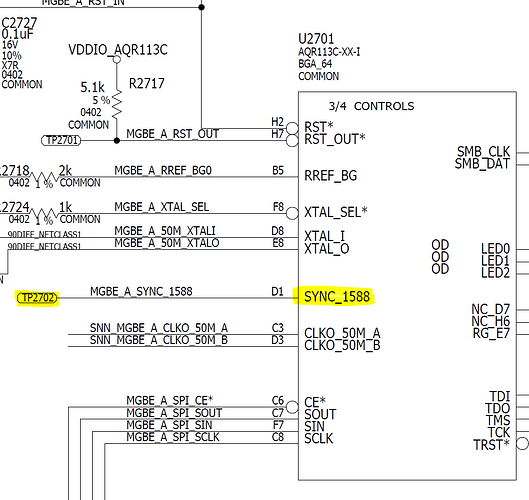

we are trying to set up a Orin-AGX Dev-Kit of yours to act as a PTP-Grandmaster.

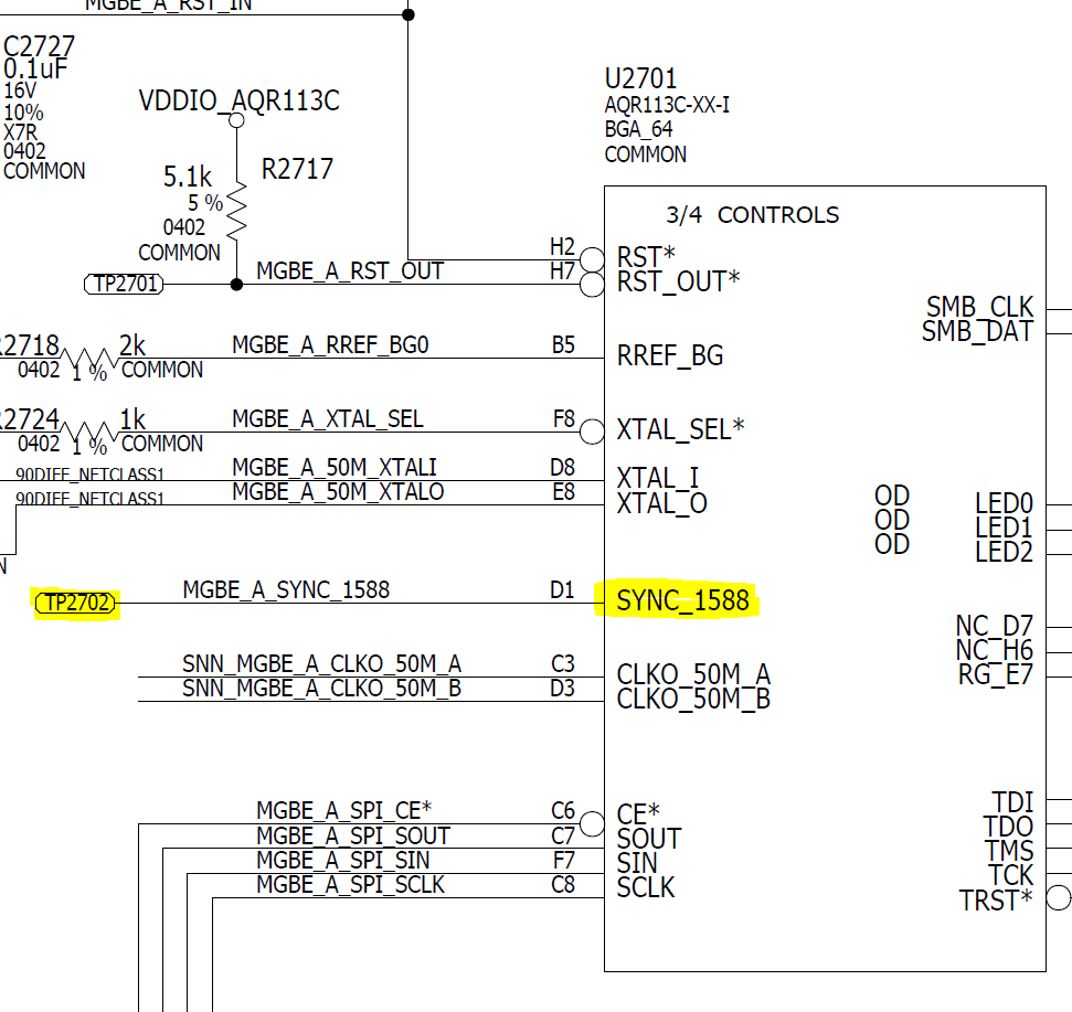

For our goal to achieve best performance we attached a PPS to the carrierboard own AQR113C sync pin, available via test point TP2702 indicated by the schematics.
Running ethtool -T we get - like many others have reported here - the output “PTP Hardware Clock: 0”.
We set chrony up for PHC via /dev/ptp0, but the time increment seems not to be driven by the PPS, as we can disconnect the PPS with no effect, and still polling an increment, but freq = 0.
We have read quite an substantial amount of posts, starting from PPS in via GPIO up to updating the AQR113 firmware, which seems to be no straight forward approach.
We hope the support or an interested reader might be able to give us a hint.
Can the ARQ113 be configured to accept the PPS, so we can use the fractional secs to control the system clock ?
Looking forward to a reply

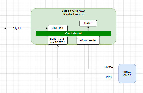

Could you share the block diagram of your connection for PPS signal? What’s the PPS source?

Block diagramm
NV Schematics
From AQR113 manual:
Sync_1588:
This is the PTP sync input used to align the PTP clocks on multiple PHYs on a platform to have the same time. The PHY timestamps the rising edge of this input and this timestamp can then be used on each of the PHYs to perform the alignment.

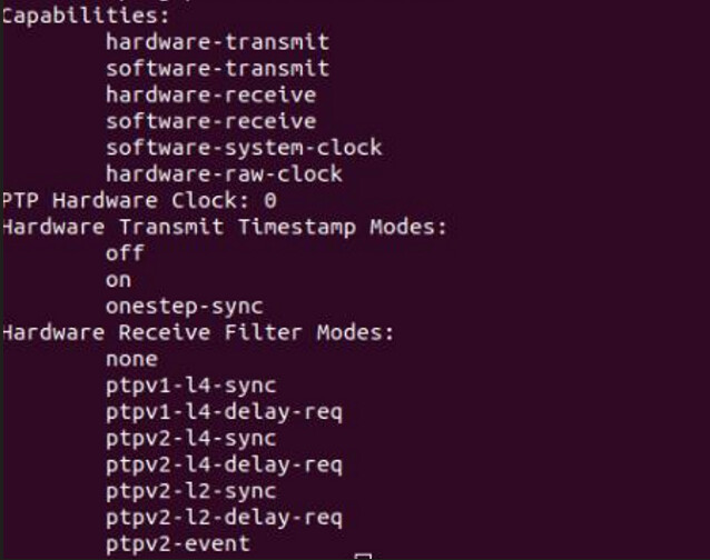

ethtool:
the latest version of ethtool available via apt is 5.16, that is what is on our Dev-Kits (5 of them in total).
This version seems to have a display bug - see No timestamp capabilities with ethtool -T.
Hence, this is the output of two of our Dev-Kits i have access to:
But i assume the timestamping capabilities should be identical to all Dev-Kits ?

We are aware of the fact, that ethtool gives us PTP Hardware Clock: 0.
/dev/ptp0 is available - as with all our Dev-Kits
/dev/ptp1 is not - as with all our Dev-Kits

So, by now we assume that the available /ptp0 is established via the nvethernet driver and the AQR113 ist not a separate PCI-Device but rather used as a PHY connected to the Jetson internal MGBE controller. Hence there is no ARQ113-PHC available. Otherweise there would be a /ptp1.
Are we correct ?
Okay, it should be /dev/ptp0 in your case.
yes, it seems you have to customize the nvethernet driver for this use case.
Or we would suggest using pps-gpio instead.

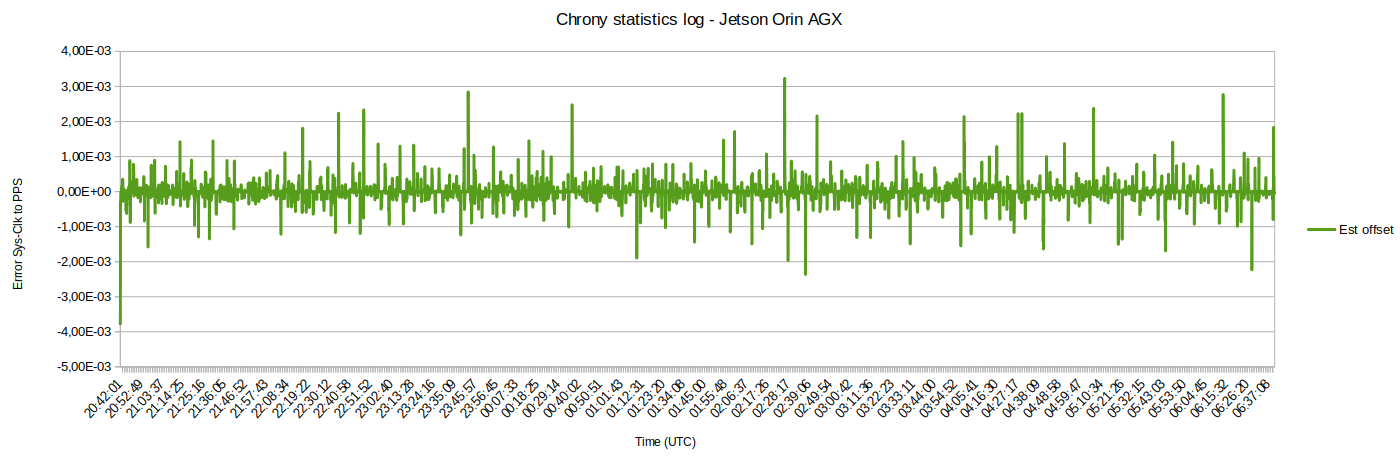

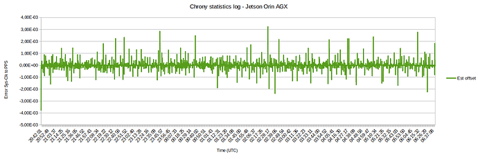

Here is a plot of the chronyc statistics log with the estimated error plotted over a period of 10h.

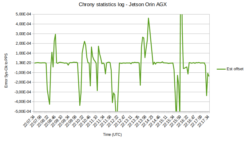

… an zoomed in for details:
We can see periods of acceptable time control with 20-50µs time error, until it goes belly up.
