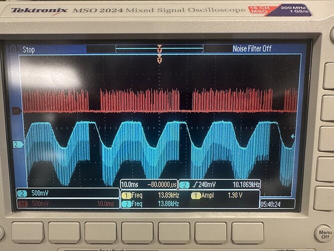

Thank you for the info of what that correct trace should look like.
I have attached the probe of the data line. I included one of the differential signals in case I had any additional interference.
The red waveform is the differential as you probably assumed.
Please try other scope with enough bandwidth. Your waveform looks not correct.
Here is a zoomed in version of the differential signal.
After increasing the bandwidth the probes here is the previous screenshot
Is this another scope? It does not show details of waveform. You can check the signals by yourself based on the MIPI specification. That would be more efficient.
This is the highest bandwidth scope I have (200 MHz @ 1 GS/s). Unfortunately I don’t have access to the MIPI specification.
Is there another way you could help me diagnose the issue?
200 MHz @ 1 GS/s is not enough for MIPI signal test. You need to find another scope with bandwidth no less than 4GHz for test.
I was able to get a hold of a 4 GHz scope. Please let me know if there are any improvements I need to make to the waveform so you can help.
What is this waveform? Can you check that first by yourself based on mipi spec?
It is a zoomed in waveform of the photos previously sent.
I don’t have access to the MIPI specification otherwise I would have tried to validate the waveform.

The waveform looks not good. MIPI spec is necessary for the design, please do check base on that or some related tests setting of scope.
