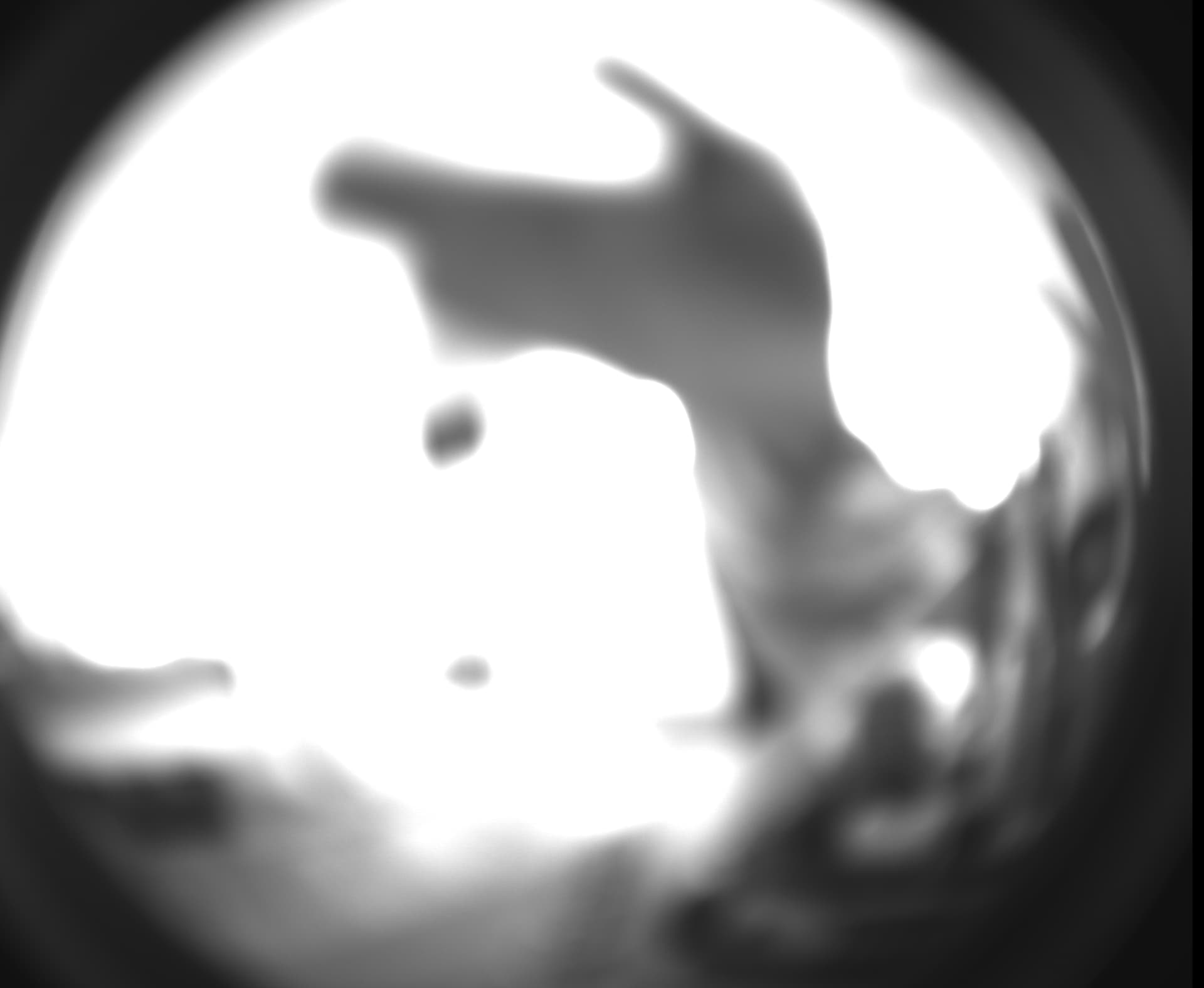

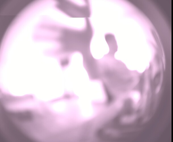

With this GStreamer pipeline I have created a series of images.
gst-launch-1.0 -e nvarguscamerasrc sensor-id=0 num-buffers=20 aelock=true aeantibanding=0 ! 'video/x-raw(memory:NVMM), width=2496, height=2048, format=NV12' ! nvvidconv ! pngenc ! multifilesink location=~/$(date +%s)-%d.png
The first images are only partially filled with a block wise structure. Later images are filled completely but also show this tear down effect.
I also have created a series of images with this command.
v4l2-ctl -c exposure=10000 -c gain=0 -c black_level=0
v4l2-ctl --set-fmt-video=width=2496,height=2048,pixelformat=RG10
v4l2-ctl --stream-mmap --stream-count=20 --stream-to=test_2496x2048x20.raw
This images are totally fine and don’t show any bad effects.
I have checked that all images provide a timestamp.
In my opinion there is a sync problem in the ISP pipeline.
Any help appreciated.

Without locked rates, the pattern of the block structure changes:
Only the isp rate needs to be locked and set to max to reproduce the pattern @peter.martienssen described.
Setting the locked isp rate to different values changes the pattern.

I managed to resolve the issue.
We had the active_w/h in the device tree set to 2488/2048 (number of recording pixles) instead of 2472/2064, which includes the margin for color processing.
With the new values, the crop effect dissapears
