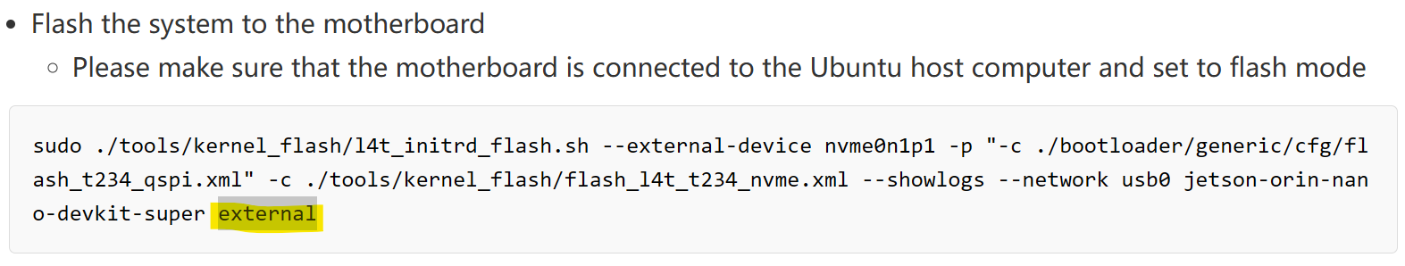

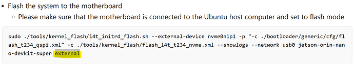

Actually, after rearranging them, both are quite identical except for the words “internal” and “external” at the end.
One example comes with a period “.” and your suggestion does not, do you foresee any issue?
And do you know why Waveshare recommend external and not internal?
The option is applied for AGX Orin modules which have internal eMMC. For Orin NX and Orin Nano, it does not take effect. Please set either external or internal.
Can I also take this opportunity to get the super Mode into ORIN NX 16GB​ (SUPER) for this board? Am I correct that the board supported, and I can use this command jetson-orin-nano-devkit-super?
$ sudo ./tools/kernel_flash/l4t_initrd_flash.sh --external-device nvme0n1p1 \
  -c tools/kernel_flash/flash_l4t_t234_nvme.xml -p "-c bootloader/generic/cfg/flash_t234_qspi.xml" \
  --showlogs --network usb0 jetson-orin-nano-devkit-super external
The mode can be enabled on developer kit. On custom board, there is further requirement and please check product design guide:

I think so, the screen grab from Waveshare indicated -super.

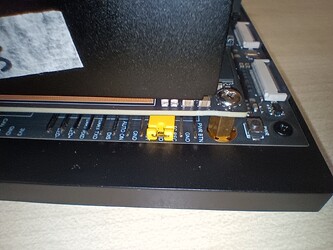

Is the failure because of this? Recovery mode is confirmed. Please install the Secureboot package to use initrd flash for fused board

[   0.0275 ] ERROR: failed to read rcm_state
[   0.3412 ] ERROR: might be timeout in USB write.
[  10.4852 ] Error: try getting custinfo fail. Moving on
Error: Return value 3
Error: failed to generate images
$ lsusb
Bus 004 Device 002: ID 0bda:0411 Realtek Semiconductor Corp. Hub
Bus 004 Device 001: ID 1d6b:0003 Linux Foundation 3.0 root hub
Bus 003 Device 006: ID 090c:1000 Silicon Motion, Inc. - Taiwan (formerly Feiya Technology Corp.) Flash Drive
**Bus 003 Device 010: ID 0955:7323 NVIDIA Corp. APX**
Bus 003 Device 004: ID 0bda:5411 Realtek Semiconductor Corp. RTS5411 Hub
Bus 003 Device 003: ID 046d:c315 Logitech, Inc. Classic Keyboard 200

Looks like the device is booted to Ubuntu instead of entering recovery mode. Please do
  1. Power off the device
  2. Put on jumper
  3. Power on the device
  4. Connect it to host PC thorough type-C to A cable
  5. Run $ lsusb on host PC to check status
I have follow your step 1 to 4.
I checked and confirm is under recovery mode.
