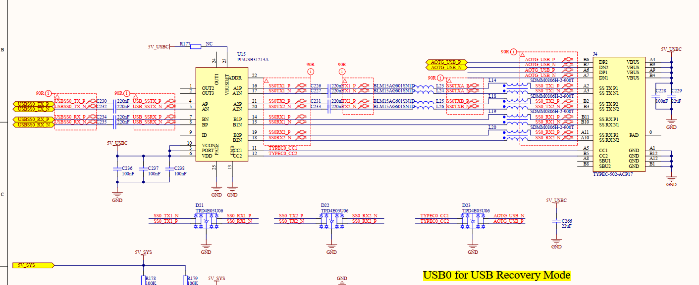

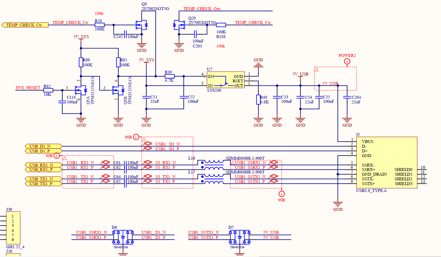

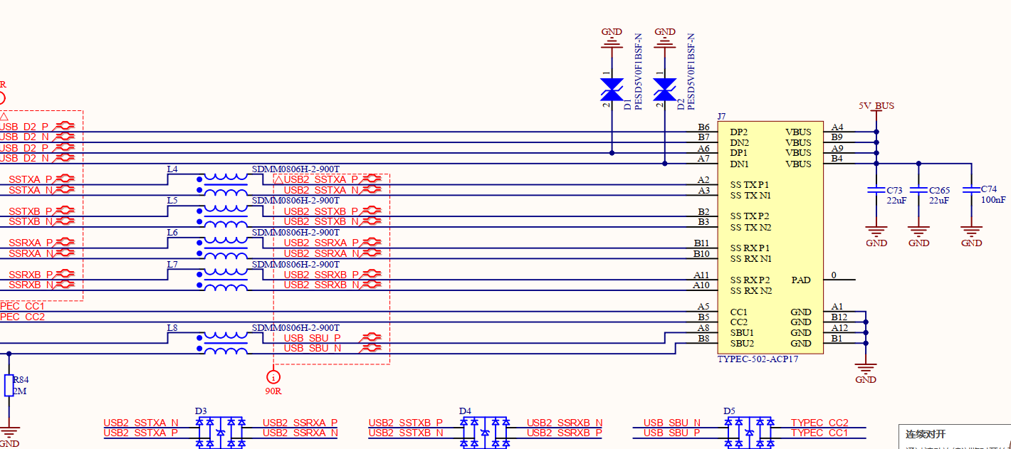

Using Customized Board to Use the three-way USB3.0 The schematic diagram is shown below.
Currently, only USB0 is recognized as USB 3.0.

For type C, please check with the type C controller vendor.
Thank you for your reply, the Type A port also cannot be recognized as 3.0.
Then please read the above document to configure your device tree.
