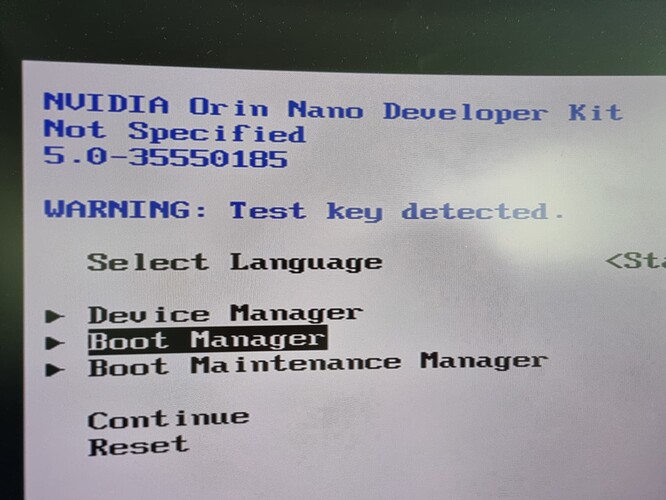

to evaluate our next update strategy I have been trying to verify the steps of how I can update from L4T 35.5.0 to L4T 36.3.0 using the Jetson Orin Nano Dev-Kit. However, it fails to boot after the OTA-update.

  2. Afterwards the system does not boot anymore, and I do see that the firmware is still the old after the reboot
So I assume this is a mismatch with the NVME and it therefore does no boot anymore. But I didn’t get to the step where I have to update the qpsi-memory from the device.
As this is a vanilla setup, I wonder what am I missing that it does not work as described in the example or the online docs. Thanks for your help!

hello lneuner,
we’ve tested OTA from r35.5.0 to r36.3.0 on Orin Nano DevKit, and it works normally.
please setup serial console to gather the complete logs after you perform $ sudo reboot to trigger OTA update.
Hi JerryChang,
thanks for the feedback. I have tried to update today another time with the console output attached and it worked. However, at the output
Validate /mnt/ota_work/external_device/system.img
[    8.264523] mmc1: SDHCI controller on 3400000.sdhci [3400000.sdhci] using ADMA 64-bit
it was hanging/waiting for close to 1min after it resumed. Is this normal?
I likely was to impatient on the first attempts as it takes quite a while till you see something on the screen again, but with the serial output this was mitigated. Thanks!
