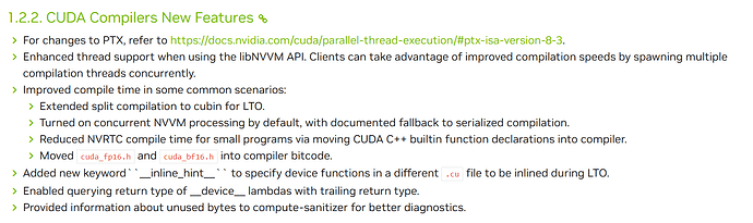

And in the CUDA 12.3 release notes (CUDA 12.3 Update 2 Release Notes) there is a section telling that improved NVVM concurrency was added:
So I thought that maybe…
