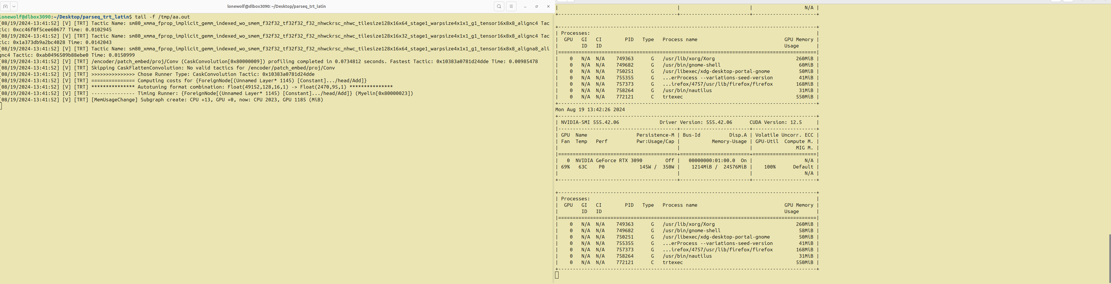

onnx to tensorrt takes for ever. GPU utilitisation is 100 % at 550 mb. I am able to convert model on another gpu with other cuda/tensorrt ubuntu versions. .

trtexec --onnx=$onnxfile --saveEngine=$trtfile --verbose #–fp16 --verbose # --skipInference --buildOnly
trt conversion gets stuck here [08/19/2024-13:59:54] [V] [TRT] Skipping CaskFlattenConvolution: No valid tactics for /encoder/patch_embed/proj/Conv
[08/19/2024-13:59:54] [V] [TRT] >>>>>>>>>>>>>>> Chose Runner Type: CaskConvolution Tactic: 0x10383a0781d24dde
[08/19/2024-13:59:54] [V] [TRT] =============== Computing costs for {ForeignNode[(Unnamed Layer* 1145) [Constant]…/head/Add]}
[08/19/2024-13:59:54] [V] [TRT] *************** Autotuning format combination: Float(49152,128,16,1) → Float(2470,95,1) ***************
[08/19/2024-13:59:54] [V] [TRT] --------------- Timing Runner: {ForeignNode[(Unnamed Layer* 1145) [Constant]…/head/Add]} (Myelin[0x80000023])
[08/19/2024-13:59:54] [V] [TRT] [MemUsageChange] Subgraph create: CPU +13, GPU +0, now: CPU 2023, GPU 1295 (MiB)
