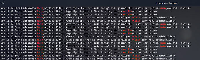

Been a while, I’ll try to be concise because I write a lot. My PC has been struggling the past weeks. It’s brand new, built by me 3~ weeks ago, and so far it’s great, it runs heavy games and everything else in general very well except when it wakes up from a sleep. It’s random, no matter the duration, but the cursor will lag hard, specially when opening or closing anything like a Konsole window or Brave tab. Things begin to crash, like Desktop Effects and Konsole if it’s open, even if it’s idle. Two or three white blurry lines blink/flicker horizontally across the screen too, and then after a while of using it like that it freezes completely (except audio, that keeps going on just fine) and only a hard reboot might fix it, not always, sometimes I gotta let all this happen 2-3 times in a row like that after rebooting for it to finally work fine (luckily, this has only happened twice, it’d lag after rebooting, and also after installing updates too, prompting me to reboot again or wait until it freezes and crashes again).

I also encountered this today after running journalctl -b -1 | grep -iE “nvidia|powerdevil|kwin|resume”, which is why I’m here, in case the GPU/driver are the culprits:
The logs after running journalctl --user-unit plasma-kwin_wayland --boot 0 are these:

What are you kernel parameters?
I don’t use Kwin, nor Wayland but my Xorg session would freeze or lag often after wakeup.
Try adding nvidia.NVreg_PreserveVideoMemoryAllocations=0 to your kernel parameters.
Also if wakeup fails, try adding a pre- and post condition in /usr/lib/systemd/system-sleep/
case “$1” in pre) /usr/bin/nvidia-sleep.sh “suspend” ;; post) /usr/bin/nvidia-sleep.sh “resume” ;; esac
Nvm, nothing worked, it still lagged again. I am out of options. There’s also a weird bug now where everything in my browser is treated like text-edit mode, I can put my blinking caret anywhere I want like buttons, text that shouldn’t be edited, or a new page’s background, it’s so weird and persistent. AI says it is because of Kwin’s event loop getting delayed, desync, the UI thinks it’s in “text-edit mode” globally, but I don’t know anymore, I think I will have to boot into a different distro and see if this happens there too.
