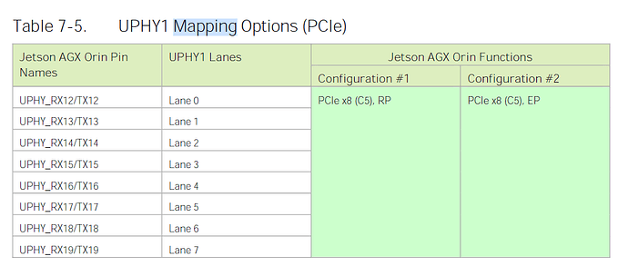

I have few queries on PCIe side-
Please let me know I/O standard used for PCIE REF CLK since as per datasheet AC coupling caps requirement depends on the end point? Please confirm it is HCSL or something else(CML, LVPECL etc)?
Can we use UPHY1 in 2x4 bifurcation mode?
As per design guide- CLKreq need 47K Pull up since it is open drain but in carrier board design file there is no pull-up on this trace (PCIE5_CLKREQ_N)?
