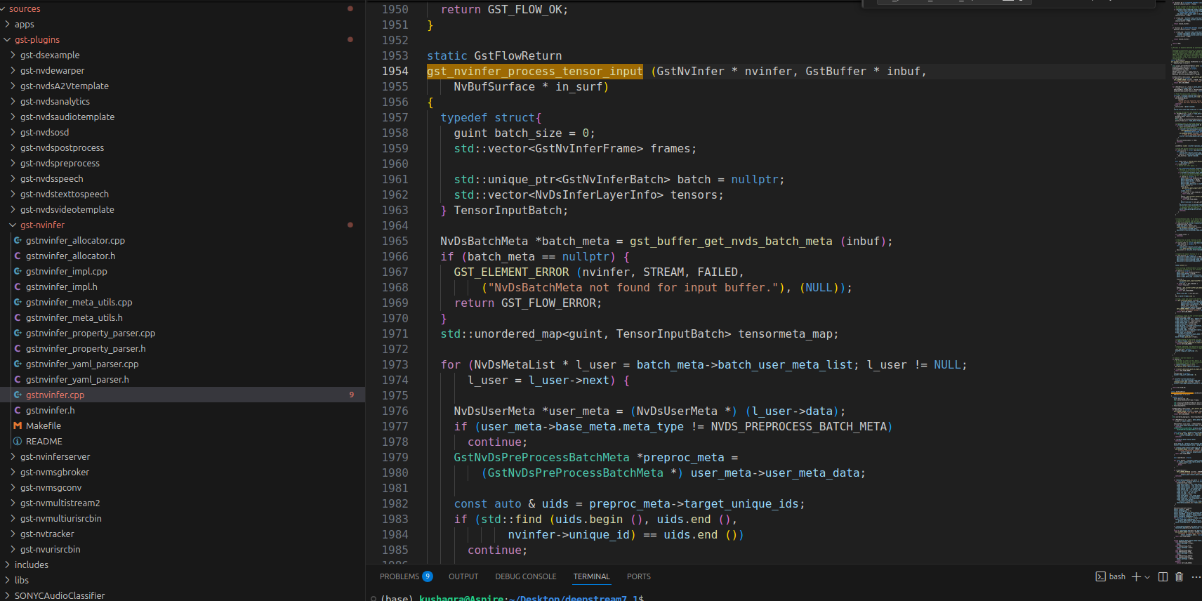

i am trying to use [pre-process] before [primary-gie] so that i get roi and the pgie only infer on the objects within the roi.
But the pgie is still operating on entire frame and detecting object and giving the red bbox.
i have attached all the required config files for referece pls help.

[pre-process]
enable=1
gpu-id=1
unique-id=5
process-on-frame=1
target-unique-ids=1;7
config-file=config_preprocess.txt
# config-file property is mandatory for any gie section.
# Other properties are optional and if set will override the properties set in
# the infer config file.
[primary-gie]
enable=1
gpu-id=0
gie-unique-id=1
operate-on-gie-id=5

the green color bbox is coming from pre-processor and red bbox is coming from the pgie
Try to add input-tensor-meta=1 in [primary-gie] group. Please refer to this configuration file /opt/nvidia/deepstream/deepstream/samples/configs/deepstream-app/source30_1080p_dec_preprocess_infer-resnet_tiled_display.txt.

still not working as expected
Did you specify gie-unique-id in the nvinfer configuration file? Please check if the function gst_nvinfer_process_tensor_input is called in the file gstnvinfer.cpp located in sources/gst-plugins/gst-nvinfer/.
yes the function is called. and i set the gie-unique-id in primaryand secondary gie

can u tell why is this not working?
There are many reasons. I can’t run your configuration and can only guess the reason. Is the input tensor name of your lpd model input_1:0? Please provide detailed log

Please keep the input tensor name the same as your model: Input.
Maintaining the same tensor shape as nvstreammux/nvinfer can yield some performance benefits.
Please follow this documentation
Done. As you mentioned but still facing issue.

when i set input-tensor-meta to 0 in [primary-gie] then only i get detection logs from deepstream.
