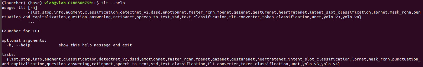

tlt --help works well
docker is ok

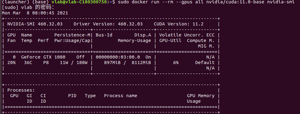

To narrow down, there is a debug way. You can check if you can login the TLT 3.0 docker.
$ docker run --runtime=nvidia -it nvcr.io/nvidia/tlt-streamanalytics:v3.0-dp-py3 /bin/bash
Thank you for your reply.
OK, It seems to be OK.
Firstly, please check if you will get error for all the modules. Try
$ tlt ssd --help
$ tlt dssd --help
etc
