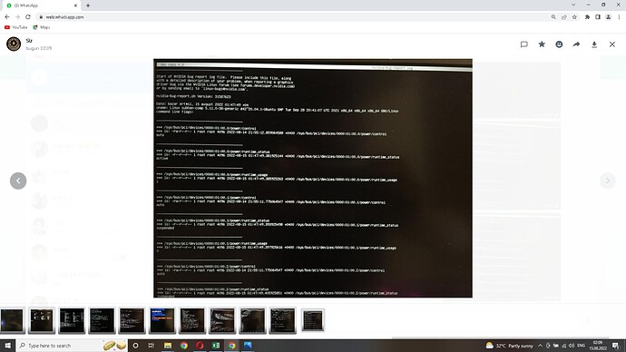

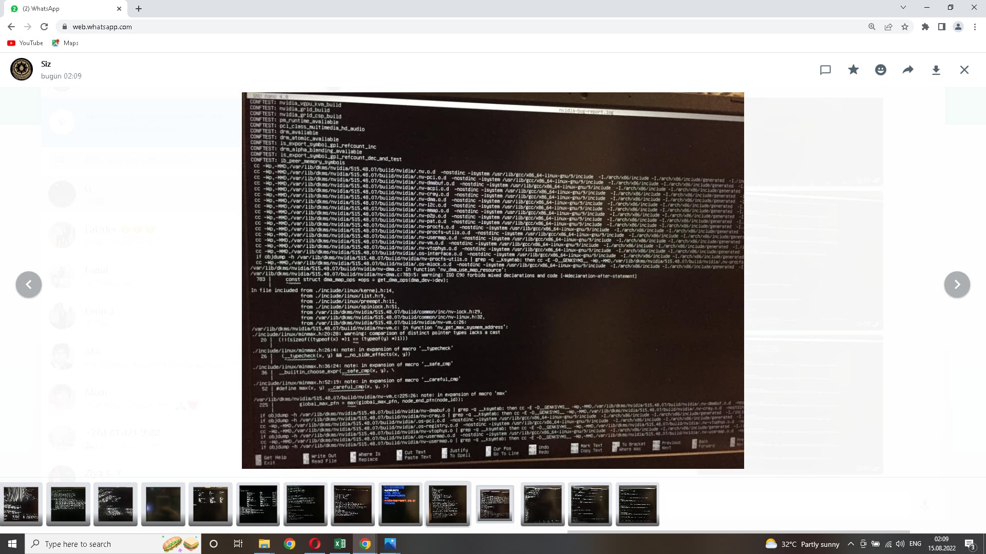

Problems after install attempt 515.48.07 driver
nvidia-bug-report.sh is in package nvidia-utils-515

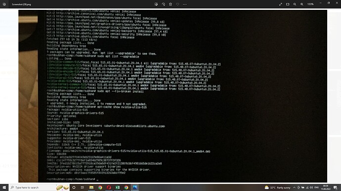

Seems the driver install is only partially. Please check if
sudo apt update
sudo apt upgrade
sudo apt --fix-broken install
fixes this. Otherwise, install nvidia-utils manually and run nvidia-bug-report.sh as root.

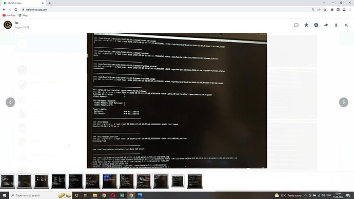

run sudo nvidia-bug-report.sh and attach the resulting nvidia-bug-report.log.gz file to your post.

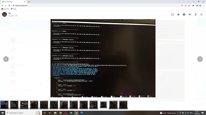

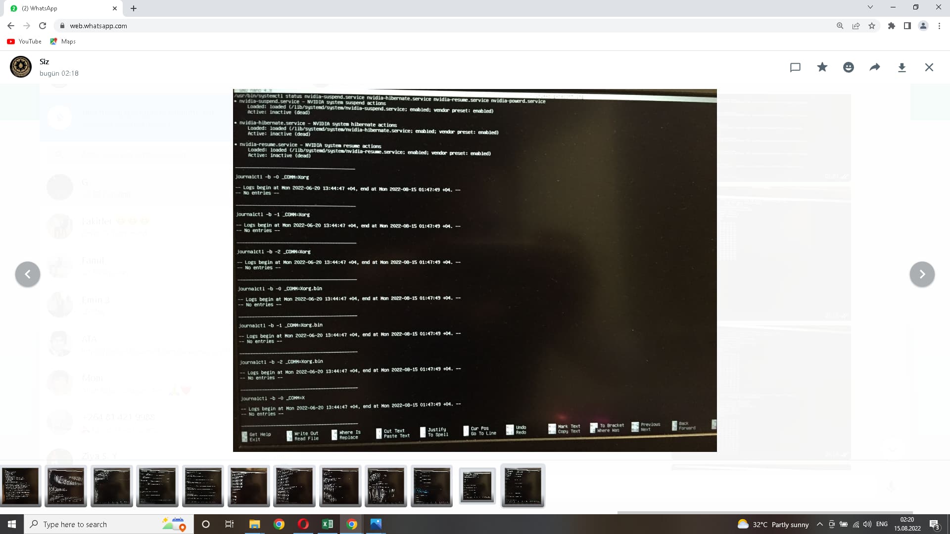

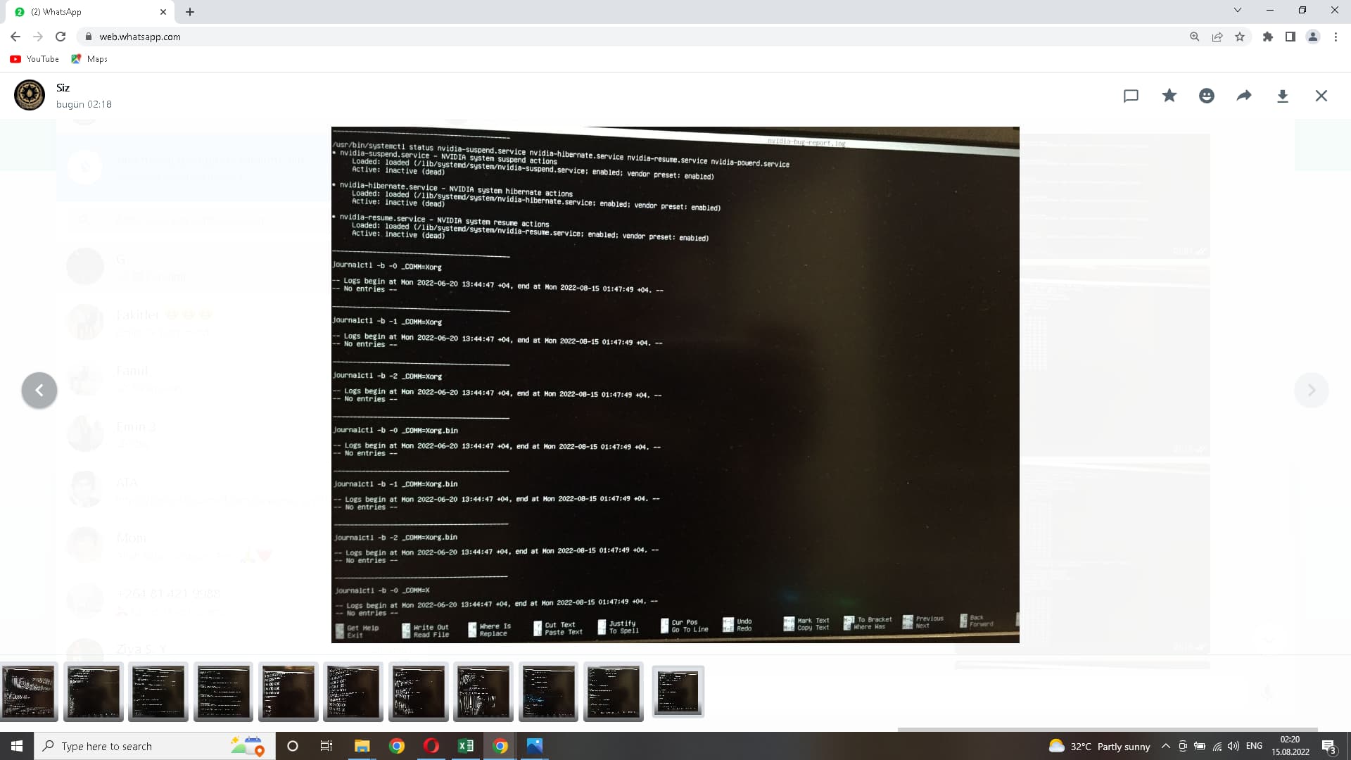

I have a black screen, how can I download it here?
would you please watch the video? then I’ll delete it so it doesn’t take up space
the part of the video after 1.15 was the last 2 pictures I posted above
If you have internet connection, you can use pastebinit to upload it from console.
  • install pastebinit (sudo apt install pastebinit)
  • unzip logfile (gunzip nvidia-bug-report.log.gz)
  • upload logfile (pastebinit -i nvidia-bug-report.log)
  • note down and post the url you’re given

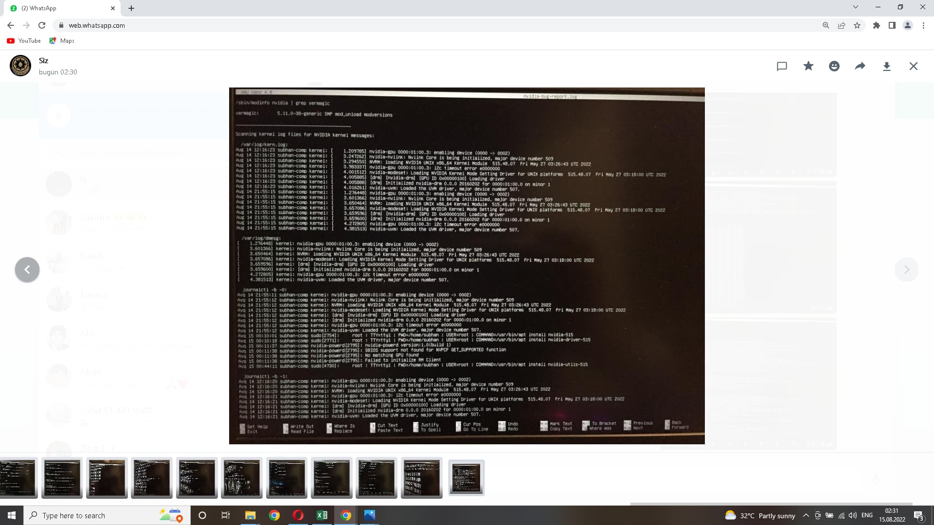

https://paste.ubuntu.com/p/wzBq3JNhpG/

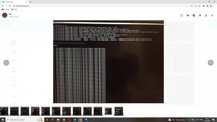

The nvidia driver is running.
To get rid of the wifi error messages, please add kernel parameter
rtw88_pci.disable_aspm=1
and reboot.

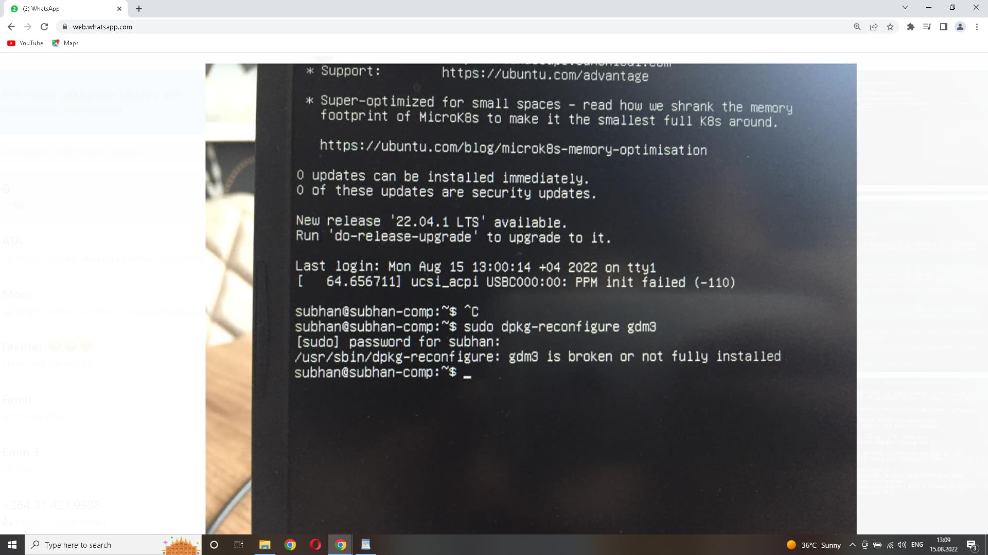

To enable the DE, please try running
sudo dpkg-reconfigure gdm3
sudo systemctl start display-manager
Please create a new nvidia-bug-report.log afterwards.

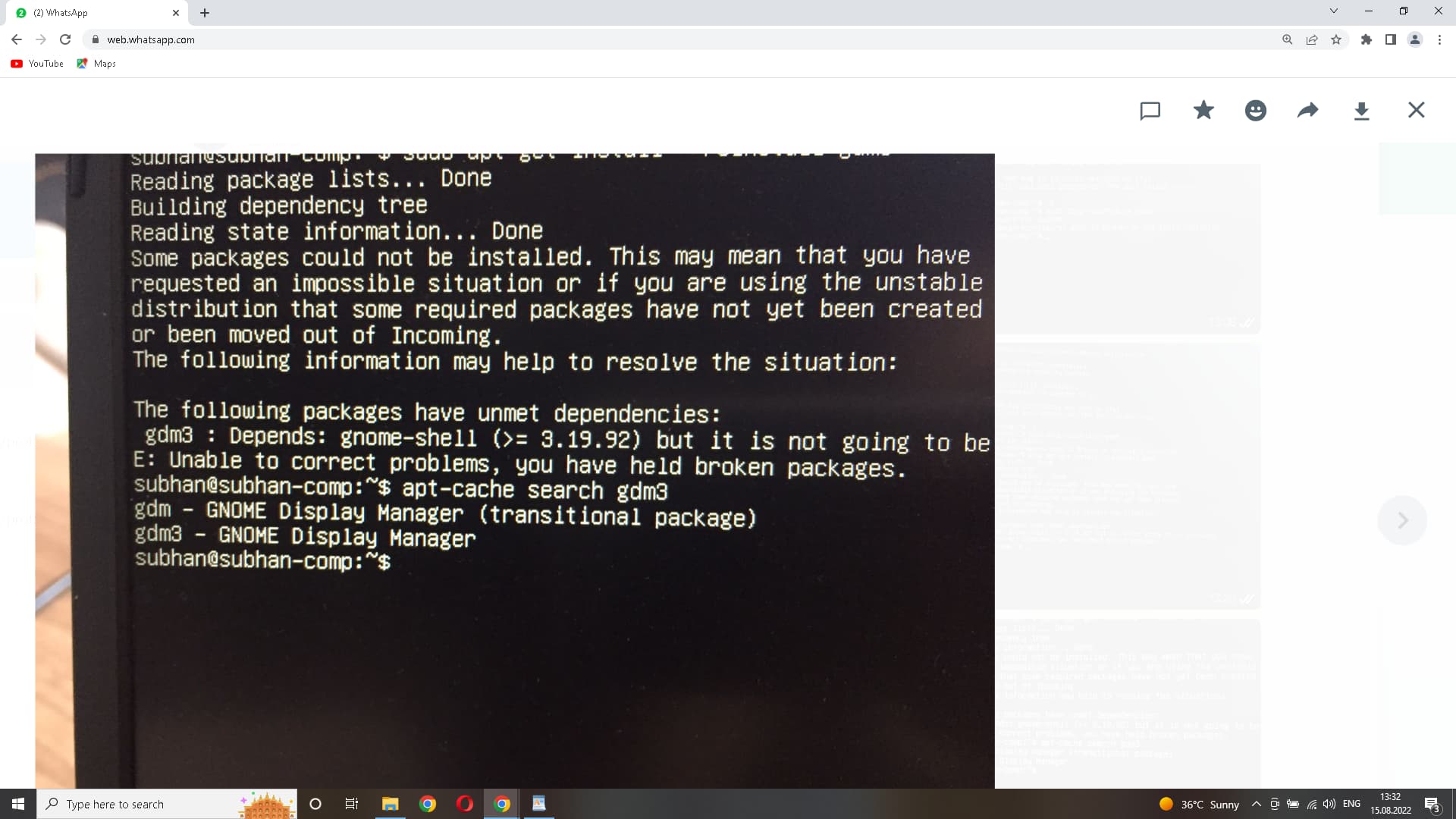

sudo apt-get install --reinstall gdm3 && sudo dpkg-reconfigure gdm3
let me run it?
is sufficient, it will run reconfigure automatically.

yes?
Try installing and using aptitude instead of apt, if that doesn’t help, reinstall ubuntu.
