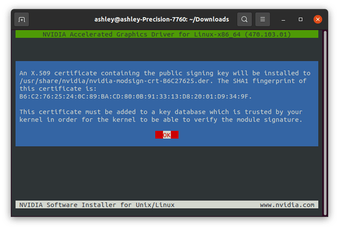

Thank you for your fast reply! Below are the outputs. As a side note I think I was able to repair what wasn’t working yesterday because when I ran ‘sudo ubuntu-drivers autoinstall’ I didn’t recieve an error and the nvidia drivers reappeared in nvidia X server settings. However while I was able to install the 510 driver, when I ran the sudo apt install nvidia-driver-515 command I got an error (below). I’d really like to know how to cleanly remove the 510 driver and download 515 with cuda extension because everything I find on youtube/formus is outdated and throws errors

HI Thank you for the reply… I tried a number of things and I am not getting the 470.103.01 to download properly
1st I uninstalled driver packages with
sudo apt-get remove --purge ‘^nvidia-.*’
sudo apt-get install ubuntu-desktop
sudo rm /etc/X11/xorg.conf
I attempted installing 470 and got an error about disabling the nouveau driver
I then disabled it them using…
ashley@ashley-Precision-7760:~$ sudo nano /etc/modprobe.d/blacklist-nouveau.conf^C
ashley@ashley-Precision-7760:~$ sudo update-initramfs -u
ashley@ashley-Precision-7760:~$ sudo reboot
after attempting to install again I an error saying I was missing libc header files So I installed libc header files with…
ashley@ashley-Precision-7760:~$ sudo apt-get install libc-dev libc6-dev gcc g++
after the next install attempt i got a message asking me if I wanted to install with or without signing. I chose without, got an error and tried reinstalling signing.
then I got the following messages…
installation wasn’t aborted but then I got this…
Just ignore, the do the uninstall and check whether the 470 libs are gone.
OK thank you…
can you please explain the --uninstall option input? I don’t see any examples of uninstalling with that online. ONly sudo-apt purge. When I attempt the following it doesn’t exist…
ashley@ashley-Precision-7760:~$ sudo apt-get --uninstall nvidia-470
[sudo] password for ashley:
E: Command line option --uninstall is not understood in combination with the other options
I’m also not sure the 470 install worked properly because nvidia-smi returns the following;
NVIDIA-SMI has failed because it couldn’t communicate with the NVIDIA driver. Make sure that the latest NVIDIA driver is installed and running.
However 470 shows here …

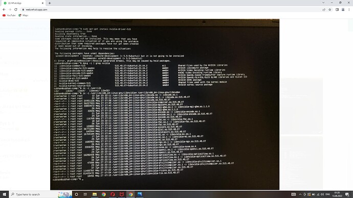

ashley@ashley-Precision-7760:~$ dpkg -l |grep nvidia
ii libnvidia-cfg1-510:amd64 510.73.05-0ubuntu0.20.04.1 amd64 NVIDIA binary OpenGL/GLX configuration library
ii libnvidia-common-510 510.73.05-0ubuntu0.20.04.1 all Shared files used by the NVIDIA libraries
rc libnvidia-compute-470:amd64 470.129.06-0ubuntu0.20.04.1 amd64 NVIDIA libcompute package
ii libnvidia-compute-510:amd64 510.73.05-0ubuntu0.20.04.1 amd64 NVIDIA libcompute package
ii libnvidia-compute-510:i386 510.73.05-0ubuntu0.20.04.1 i386 NVIDIA libcompute package
rc libnvidia-compute-515:amd64 515.48.07-0ubuntu0.20.04.2 amd64 NVIDIA libcompute package
ii libnvidia-decode-510:amd64 510.73.05-0ubuntu0.20.04.1 amd64 NVIDIA Video Decoding runtime libraries
ii libnvidia-decode-510:i386 510.73.05-0ubuntu0.20.04.1 i386 NVIDIA Video Decoding runtime libraries
ii libnvidia-encode-510:amd64 510.73.05-0ubuntu0.20.04.1 amd64 NVENC Video Encoding runtime library
ii libnvidia-encode-510:i386 510.73.05-0ubuntu0.20.04.1 i386 NVENC Video Encoding runtime library
ii libnvidia-extra-510:amd64 510.73.05-0ubuntu0.20.04.1 amd64 Extra libraries for the NVIDIA driver
ii libnvidia-fbc1-510:amd64 510.73.05-0ubuntu0.20.04.1 amd64 NVIDIA OpenGL-based Framebuffer Capture runtime library
ii libnvidia-fbc1-510:i386 510.73.05-0ubuntu0.20.04.1 i386 NVIDIA OpenGL-based Framebuffer Capture runtime library
ii libnvidia-gl-510:amd64 510.73.05-0ubuntu0.20.04.1 amd64 NVIDIA OpenGL/GLX/EGL/GLES GLVND libraries and Vulkan ICD
ii libnvidia-gl-510:i386 510.73.05-0ubuntu0.20.04.1 i386 NVIDIA OpenGL/GLX/EGL/GLES GLVND libraries and Vulkan ICD
rc linux-modules-nvidia-470-5.13.0-1010-oem 5.13.0-1010.11 amd64 Linux kernel nvidia modules for version 5.13.0-1010
ii linux-objects-nvidia-470-5.13.0-1010-oem 5.13.0-1010.11 amd64 Linux kernel nvidia modules for version 5.13.0-1010 (objects)
ii linux-objects-nvidia-470-5.13.0-1029-oem 5.13.0-1029.36+1 amd64 Linux kernel nvidia modules for version 5.13.0-1029 (objects)
ii linux-signatures-nvidia-5.13.0-1010-oem 5.13.0-1010.11 amd64 Linux kernel signatures for nvidia modules for version 5.13.0-1010-oem
ii linux-signatures-nvidia-5.13.0-1029-oem 5.13.0-1029.36+1 amd64 Linux kernel signatures for nvidia modules for version 5.13.0-1029-oem
ii screen-resolution-extra 0.18build1 all Extension for the nvidia-settings control panel
ii xserver-xorg-video-nvidia-510 510.73.05-0ubuntu0.20.04.1 amd64 NVIDIA binary Xorg driver

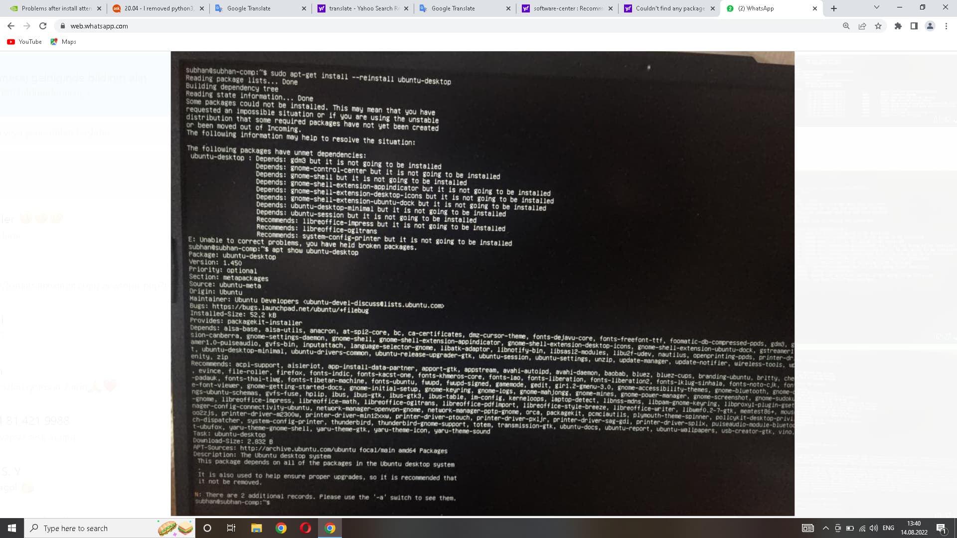

Hi. we would have helped me. I did not know that I removed men python3 and then the screen went black. ppm init failed error (-110). Got it, drive related. Now I want to download nvidia-driver 515. It shows me wine64-development: Recommends wine32-development.
sudo apt-get install ubuntu-desktop this image
I already have ubuntu-desktop, maybe it can’t load it or it’s an old version ?

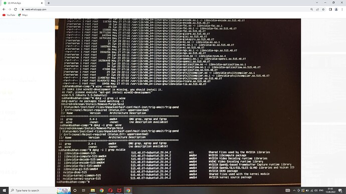

I forgot something wine --version shows
.My computer supports wine64-development why does wine32-development ask me to download it?
