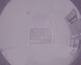

This very simple Python script fixes the image color, after discarding the 4MSBs for an image saved with NvRaw (.raw format) :
with open(file_path, 'rb') as f:
raw_data = f.read()
# Image is 16-bit and stored in little endian format
image_data = np.frombuffer(raw_data, dtype=np.uint16)
# Discard the last 4 bits of every hexadecimal
image_data = image_data >> 4
# Convert to 12 bits
image_data = image_data & 0xFFF
# Reshape the image
image_data = image_data.reshape((height, width))
# Debayer the image using OpenCV
bgr = cv2.cvtColor(image_data, cv2.COLOR_BAYER_BG2BGR)
# Display as 8 bits using OpenCV
image_data = (bgr / 16).astype(np.uint8) # (12-8 = 4 -> 2^4 = 16)
Sorry, I can’t remember many details as I ended up not using that mode for my image sensor. It has been a long time, so I vaguely remember the 16-bit output put the video pipeline in HDR mode. So maybe you need to set some more options in either your dts file or camera_overrides.isp file related to HDR (unsure).

I don’t understand what you meant “fixes” the 4 repeated MSBs.
the flow looks like… [Sensor] → [CSI] → [VI] → [ISP]. whereas ISP output is YUV420.
let me check this internally,
in the meanwhile, how about you capture the nvraw and jpg and attach that for reference,
you may using nvargus_nvraw to capture both of them simultaneously.
for instance, $ sudo nvargus_nvraw --c 0 --mode 0 --format "nvraw, jpg" --file /home/nvidia/output
