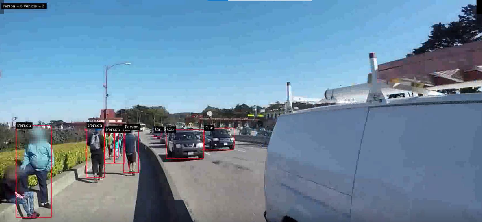

  1. Add a define at the very beginning of /opt/nvidia/deepstream/deepstream-5.1/sources/apps/sample_apps/deepstream-test1/deepstream_test1_app.c
#define GST_PIPL_INIT_ERROR(g_obj, name) \
  do{ \
    if (!g_obj) { \
      g_printerr ("%s could not be created. Exiting.\n", name); \
      return -1; \
  } while(0)
You are good to go. And enjoy playing with this demo by saving a mp4 file on the device.
