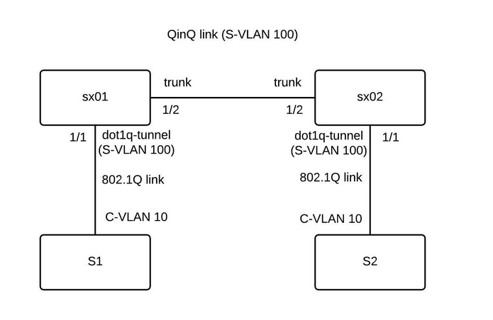

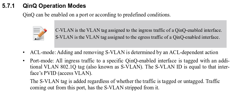

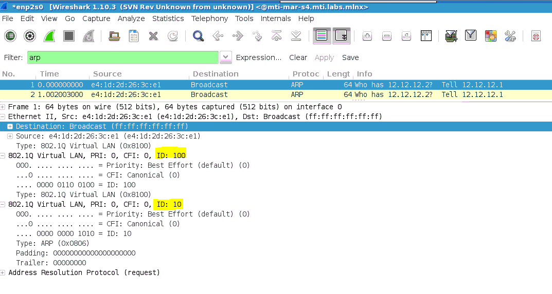

According to the QinQ documentation below the switch adds an additional 8021.Q tag 0x8100 (along with the S-VLAN) for a dotq tunnel port.
Is it possible to add IEEE 802.1ad standard based Ethertype 0x88A8 instead ?
Is there any CLI option available to use a custom Ethertype say 0x9100 or 0x88A8 like some other vendors support ?
