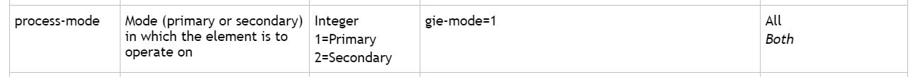

process-mode for sgie is 2, you can refer to docomentation
•Secondary mode: Operates on objects added in the meta by upstream components
also you can see sample code sources/apps/sample_apps/deepstream-infer-tensor-meta-test/ which demonstrate “creates multiple instances of “nvinfer” element. Each instance of the “nvinfer” uses TensorRT API to infer on frames/objects. Every instance is configured through its respective config file and enable
each instance to generate raw tensor data on full frame or object.”

I did receive the tensor data, and the focus of my issue lies on 2 conceptions: " process-mode" and "interval.
I read the detail of nvinfer plugin (https://docs.nvidia.com/metropolis/deepstream/plugin-manual/index.html#page/DeepStream_Plugin_Manual%2Fdeepstream_plugin_details.02.01.html%23wwpID0E0GX0HA), and find that: 1. the primary-mode can be used on both detector, classifier, primary and secondary, and there can be several primary-mode in a pipeline; 2. the “interval” property can only use on the primary-mode and it will take effect on the fllowing secondary-modes which are based on the primary-mode. Am I right?
In fact, I am more interesting on the 2.
yes you are right.
