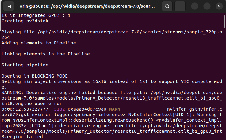

• Hardware Platform (Jetson / GPU) Jetson Orin Nano
• DeepStream Version 7.0
• JetPack Version (valid for Jetson only) 6.0
• TensorRT Version 8.6.2.3
when I run
$ cd /opt/nvidia/deepstream/deepstream-7.0/sources/apps/deepstream_python_apps/apps/deepstream-test1
$ python3 deepstream_test_1.py /opt/nvidia/deepstream/deepstream-7.0/samples/streams/sample_720p.h264
WARNING: Deserialize engine failed because file path: /opt/nvidia/deepstream/deepstream-7.0/samples/models/Primary_Detector/resnet18_trafficcamnet.etlt_b1_gpu0_int8.engine open error
But I cannot find resnet18_trafficcamnet.etlt_b1_gpu0_int8.engine in my folder.
I try install again with SDK Manager.
The same Warning about cannot find "resnet18_trafficcamnet.etlt_b1_gpu0_int8.engine "
Screenshot from 2024-10-12 08-00-27
The gst-nvinfer will generate the engine file itself for the first time run. It is OK to see such log.
