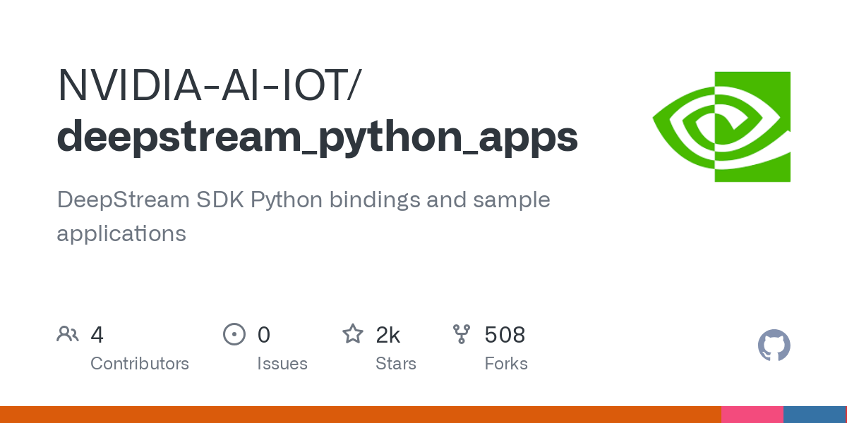

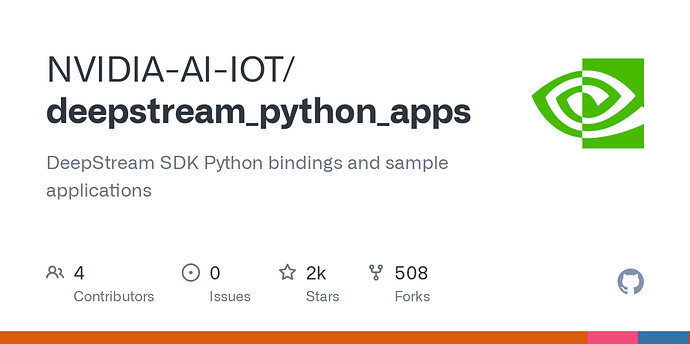

If you want to run inference on JetPack 6.1+, please check Jetson AI Lab or Deepstream SDK.
Jetson AI Lab: focus on LLMs
Deepstream SDK: focus on vision or multimedia
