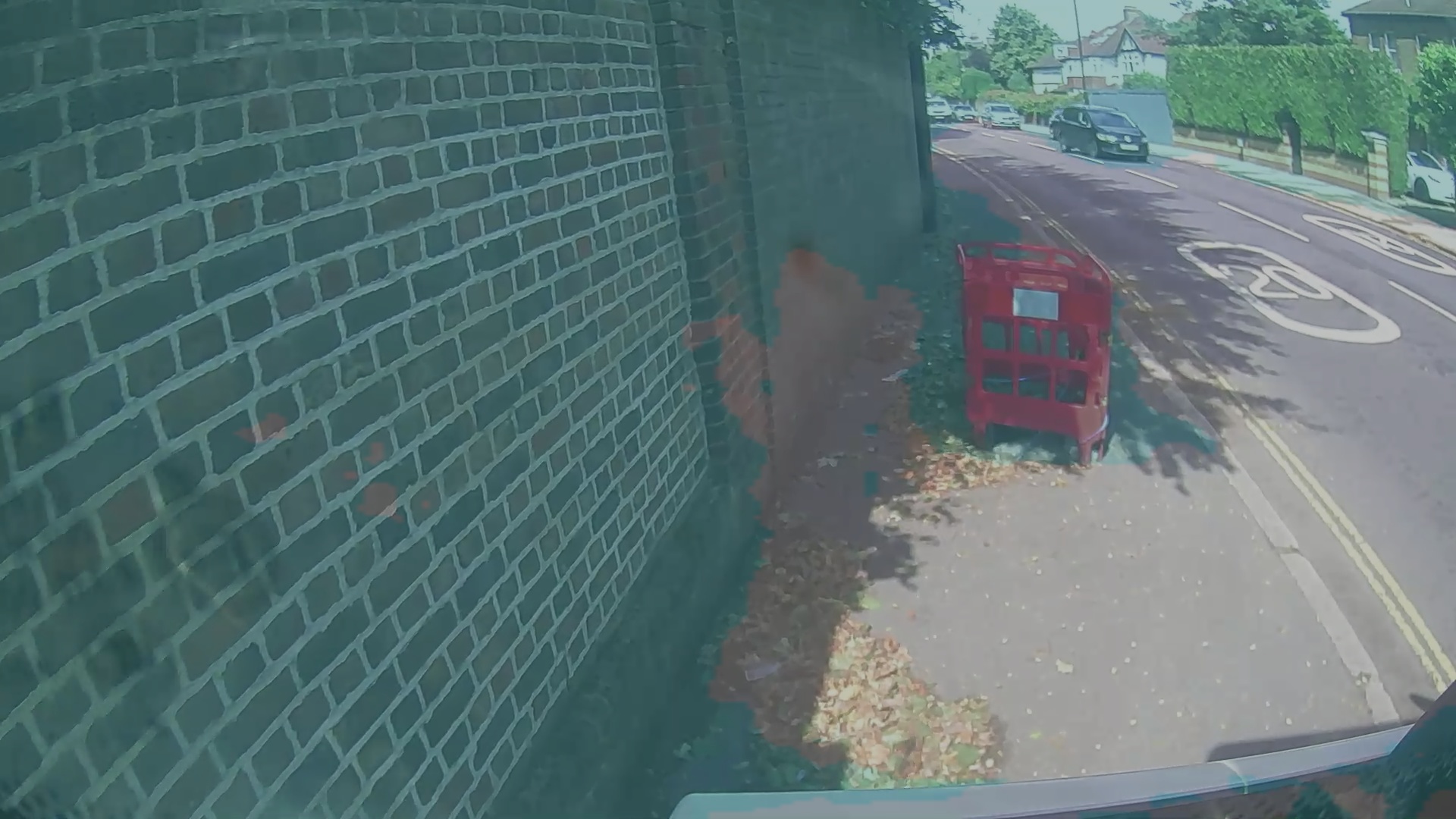

I can geyt the segmask to overlay on the images but filtering out class id’s still don;t work
my label file
road
sidewalk
building
wall
fence
pole
traffic light
traffic sign
vegetation
terrain
sky
person
rider
car
truck
bus
train
motorcycle
bicycle
even if i add the line
filter-out-class-ids=0;1;2;3;4;5;6;7;8;9;10;11;12;13;14;15;16;17;18;19
I would see inferences (see image below, this is a saved image from the buffer probe)
I’m not bothered about the quality of the inference here (becasuse we will plug in a better model) butI want to understand how this setup works (e;g; I want to filter out everything but the road, I don;t want to see the siudewalk)
secondly I would like to have this kind of overlayed output to the display (as this is a part of a demo) when I try segvisual I can only see the segmentaion output which isn;t really helpful. without a nice overlay (ideally where I can control alpha to adjust the blend in amount)
pipeline topology
output_seg.zip (97.9 KB)
can you make some suggestions to holw to make class filtering work and overlay segmentation please.
Cheers

Also nvsegvisual doesn;t seem to have properties original-background and alpha anymore check link to docs is there a way to achieve the same result some other way?
Do you mean that the following configuration will not work, network-type=100 and cluster-mode=2?
As described in the guide, filter-out-class-ids is used to filter out detected objects belonging to specified class-ids.
Yes.
There may be some supporting parameters that we didn’t show on the Guide. You can refer to the parameters by gst-inspect-1.0 nvsegvisual.
Thanks for the quick answer , filtering out not working with segmentation explains the odd behaviour.
Network mode 100 does not produce segment masks but it think pythonifying the c code above can help with that issue. (And does cluster mode 2 work with segmentation?)
Gst-inspect nvsegvisusl does not show the extra options for me. From which DS version do those extra controls are supported?
We want to make this work in deepstream 6.2.
Can we patch that element (segvisual) so it has the overlay functionality.
For example pull the deb file directly and install it?
If not I guess we can create a tee and do ‘nvsegvisual’ on one branch and use a mixer to blend the two and then convert back with a converter and present to a sink
Yes. Since we cannot support that for DeepStream 6.2, you can implement yourself, including the filter function.
Thanks, out of curiosity which DS does the native overlaying work for segvis?
What do you mean by native overlaying work?
Apologies This might be me not understanding segvisual
I meant, A DeepStream Version in which anvsegvisual element exists with such capabilites as the ability to overaly the segmask rather than only forward the segmask.
for example here
I think original_background refers to the original buffersurface aka the OG input image from the stream (be it a camera or a file etc) and alpha refers to the alpha value of the mask.
I’m only assuming here becase there is no documentaion or gst-inspect to clear the muddiness surrounding this
