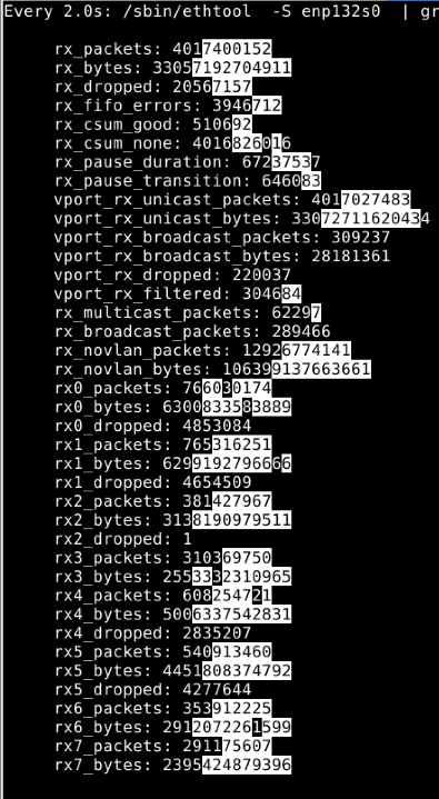

I’m getting rx_fifo errors and rx_dropped_errors receiving UDP packets. I have 8 applications each receiving ~8000 byte UDP packets from 7 different pieces of hardware with different IP addresses. The packet and data rate is identical for each application - totalling 440k packets/sec and 29 Gbit/sec respectively. The packets are all transmitted synchronously, at a rate of 2x8000 byte packets every 1.5 ms for each of 56 different hardware cards.

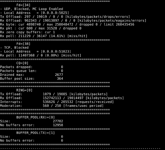

In this mode, rx_dropped and rx_fifo_errors increased at a few tens of packets per second. Attached is a dump of what ethtool shows. vma_stats shows no dropped packets. Each application is bound with numactl to NUMA node 1 (which is is where the NIC is attached). top shows each core on that node is running at < 40% CPU. The switch shows no dropped packets.
Libvma configuration as shown below. I had the same problem when not using libvma (i.e. vanilla linux kernel packet processing).

If you are seeing the same behaviour without VMA, why to complicate the problem? Start tuning the system and see if it helps. Adding more components will not help to troubleshoot. After tuning, I would suggest to check netstat -s/nstat and ‘netstat -unp’ to check the receive queue size.
The tuning guides are available from Mellanox site - Performance Tuning for Mellanox Adapters https://community.mellanox.com/s/article/performance-tuning-for-mellanox-adapters
You also might check what is the current number of send/receive queues configured on interface and try to limit it to 16
ethtool -L rx 16 tx 16
number of channels - is how many queues show be created
ring size - what is the size of the queue
Generally, you shouldn’t be changing the default as they are based on the vendor experience (any vendor), however sometimes it is better to play with these settings. For example, setting number of receive queue to the number of CPUs on the host might be not a bad idea as larger number of queue will cause to more context switches that might cause to degradation.
The same with queue size - setting it to maximum means increase amount of memory used by the queue and that might cause to page swapping, that also might cause to degradation.
Bottom line, there is no single recipe, but optimum defaults. Every change, need to be validated by running benchmarks that close to mimics behaviour of the real-time application or by application itself.
Do you still have dropped packets after changing these parameters?
I would recommend to check also RedHat network performance tuning guide if you work with TCP/UDP. For VMA is is not really applicable as VMA bypass the kernel.

Thanks for your reply. I’ve done all the performance tuning steps from the site you recommend. I tried VMA because I was expecting someone would say “Have you tried VMA?”, also vma_stats seems to give more visibility of the various buffer sizes (and errors) than available via the kernel.

Thanks for the tip on ethtool -L. Below are my current settings. I’ll have a play with it and see if things improve. I hadn’t seen that before. I wonder why it isn’t in the tuning guides?
Also:
  • What’s the difference between the ‘rings’ (ethtool -g) and ‘channels’ (ethtool -L)?
  • Why does making the channels smaller help?
ban115@tethys:~$ /sbin/ethtool -g enp132s0
Ring parameters for enp132s0:
Pre-set maximums:
RX: 8192
RX Mini: 0
RX Jumbo: 0
TX: 8192
Current hardware settings:
RX: 8192
RX Mini: 0
RX Jumbo: 0
TX: 512
ban115@tethys:~$ /sbin/ethtool -L enp132s0
no channel parameters changed, aborting
current values: tx 8 rx 32 other 0 combined 0
