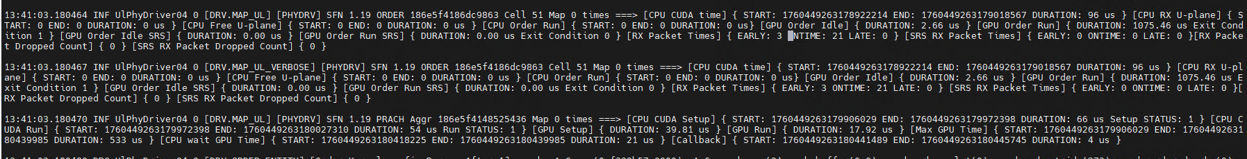

RX Packet counter stuck at 24 packets in OAI gNB develop branch and NVIDIA Aerial SDK 25-2
I am running OAI gNB develop branch and NVIDIA Aerial SDK 25-2 on a GH200 server. Both the OAI gNB and Aerial SDK is run in separate docker containers.
I am trying to integrate the NVIDIA Aerial cuBB with a n79 Radio
Band : n79
Bandwidth : 100MHz
Absolute Center Frequency : 718000
I face an issue in attaching the UE, I have received the PRACH on the gNB console and the console sends the RAR message as well. However the Msg3 timeout gets triggered and the UE fails to attach.
On further inspection of the packet counters I find that the RX counters is stuck at 24 and does not seem to increase more than that.
I have attached a screenshot below:
