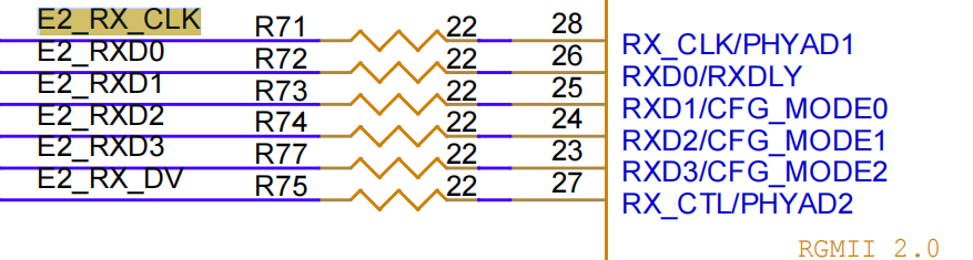

Orin RGMII RX[0:3] → PHY RX[0:3],Is this connection incorrect?
You could check pinmux setting by directly reading register for each pin.
If they are all correct, please review hardware or check with PHY vendor.

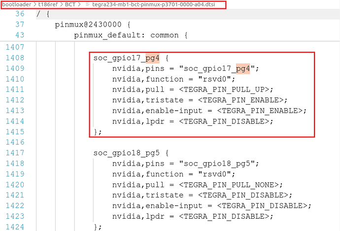

管脚配置没问题

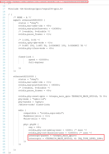

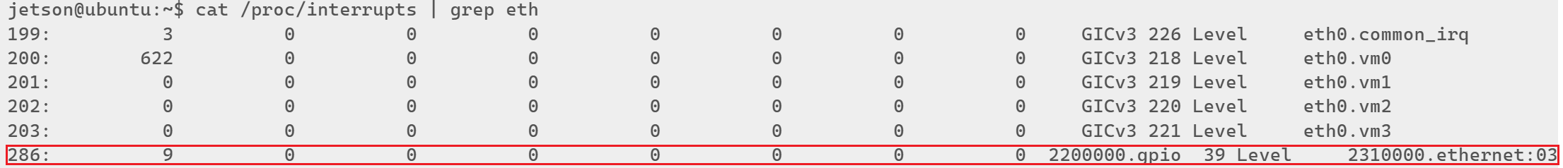

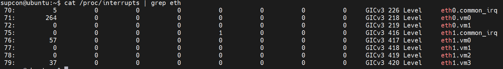

The image above shows the result of my command cat /proc/interrupts | grep eth , which is printed by me. Compared to the results printed by other developers, the output is missing the part highlighted in red as shown below.

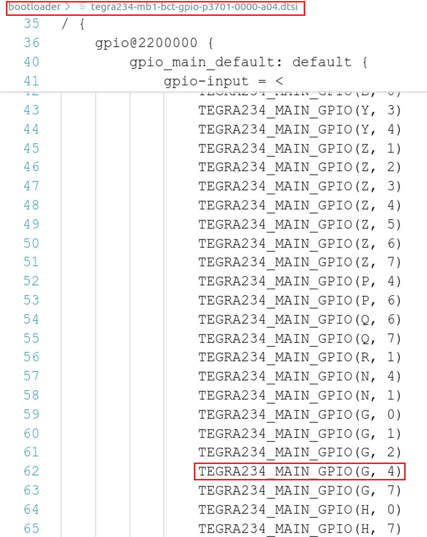

Then you forgot to set the interrupt pin to GPIO input.

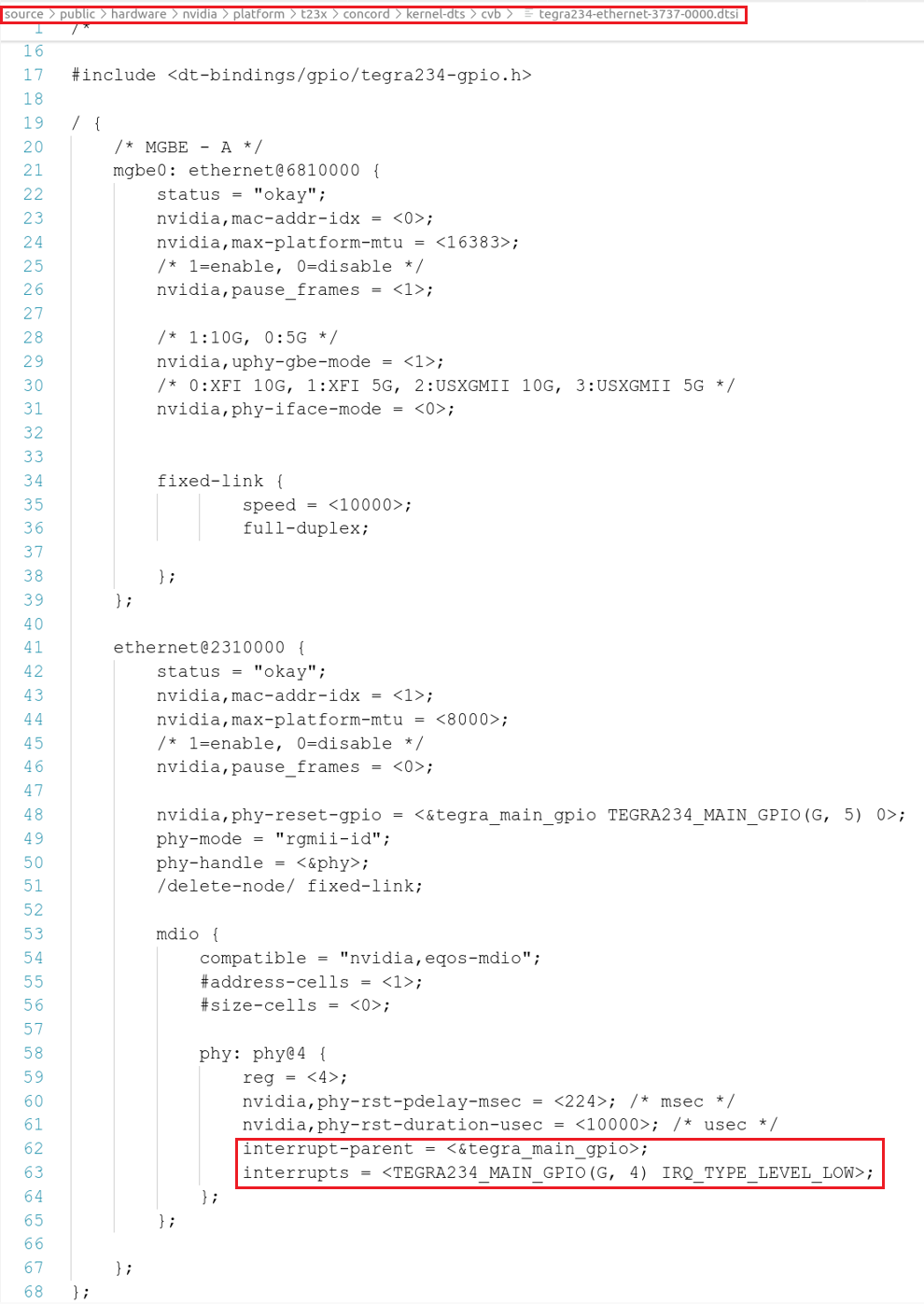

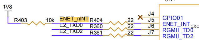

The PHY interrupt pin uses GPIO3_PG.04, as shown in the image below:

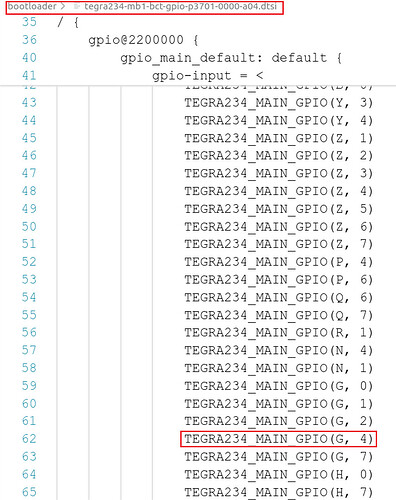

The modifications related to the device tree are shown in the image below:
Is there something missing that still needs to be modified?
Are you sure the pinmux file is the one your board is using?

pinmux and gpio setting are separate register. You should check gpio register too.

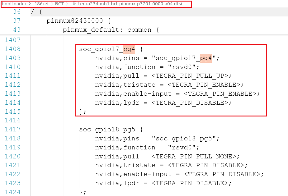

I understand. I modified the following two files, and the detailed modifications can be found in the previous reply.
tegra234-mb1-bct-gpio-p3701-0000-a04.dtsi
tegra234-mb1-bct-pinmux-p3701-0000-a04.dtsi
I mean did you read the gpio register on the board or not…

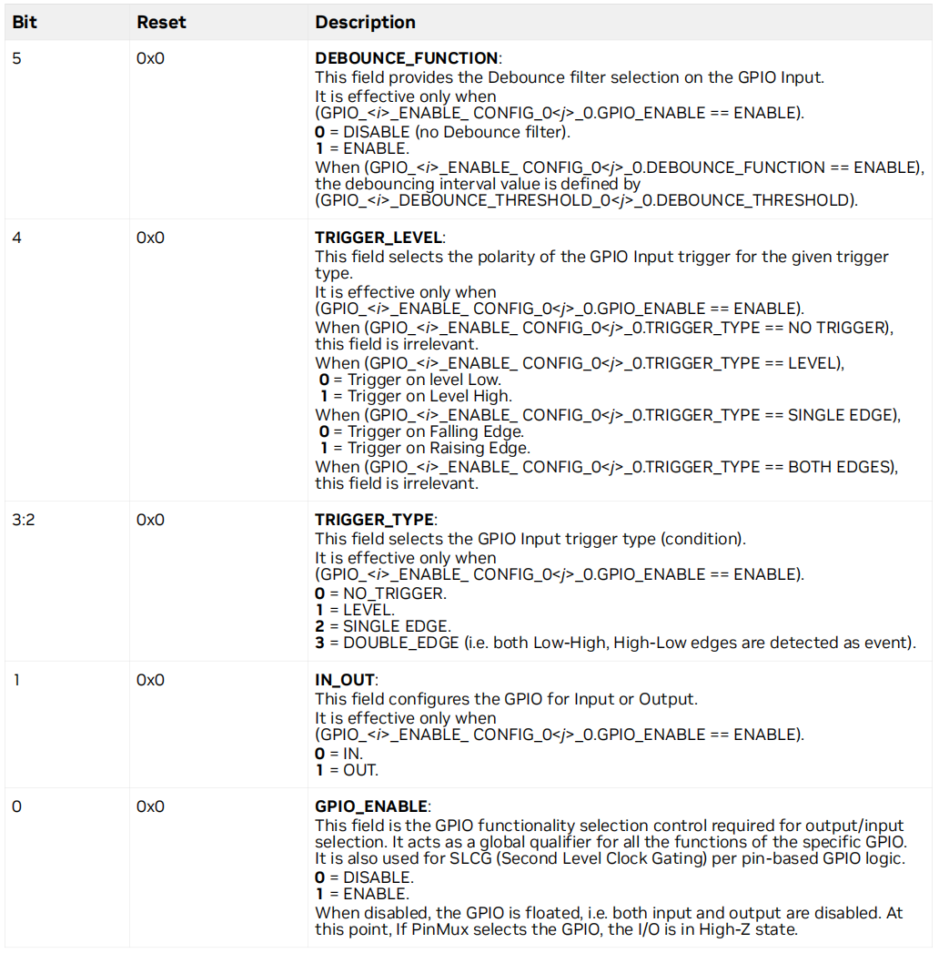

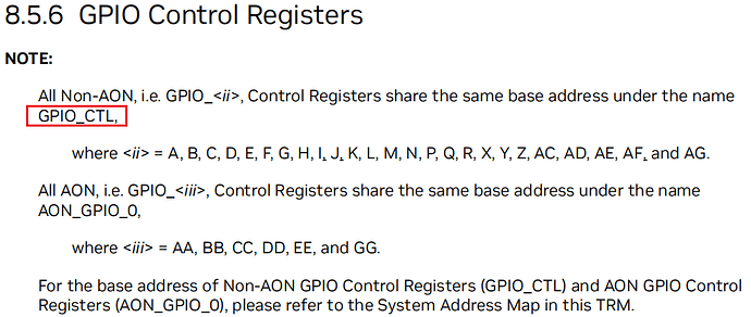

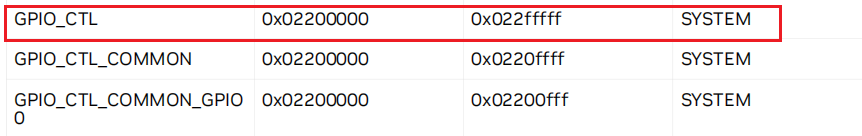

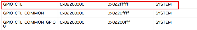

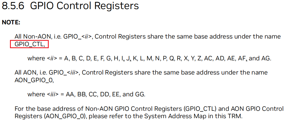

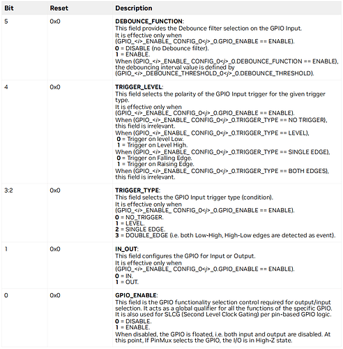

Is the register address and value read for soc_gpio17_pg4 as ENET_INT_N correct? As shown in the figure below, according to the TRM manual, only the input function is enabled?
Are you sure your device tree change for kernel really takes effect ?
Viewing the flashing log, the file used is tegra234-mb1-bct-pinmux-p3701-0000-a04.dtsi . Previously, the wrong file tegra234-mb1-bct-pinmux-p3701-0000.dtsi was modified, which resulted in an error as shown in the image below.

PG.04 pinmux:
sudo busybox devmem 0x02434070
0x00000058
PG.04 gpio config:
sudo busybox devmem 0x02214080
0x00000001

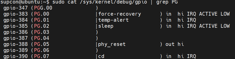

sudo cat /sys/kernel/debug/gpio | grep PG
gpio-347 (PGG.00 )
gpio-383 (PG.00 |force-recovery ) in hi IRQ ACTIVE LOW
gpio-384 (PG.01 |temp-alert ) in hi IRQ
gpio-385 (PG.02 |sleep ) in hi IRQ ACTIVE LOW
gpio-386 (PG.03 )
gpio-387 (PG.04 )
gpio-388 (PG.05 |phy_reset ) out hi
gpio-389 (PG.06 )
gpio-390 (PG.07 |cd ) in hi IRQ
The PG.04 pin interrupt function is not enabled.
