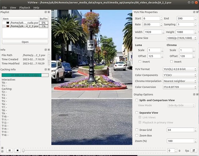

First, thx for your reply, it works!
However, I’ve met another problem. Now I can get the yuv stream from h264, however it seems to be abnormal.
Could u pls check this again? Attached two images were both decoded from sample_outdoor_car_1080p_10fps.h264, the former is by sample/00_video/decode, and the later is by ffmpeg(ffmpeg -i ./sample_outdoor_car_1080p_10fps.h264 -pix_fmt nv12 sample_h264_ffmpeg_dec.yuv)
We don’t observe the issue. Do you see this phenomenon in playback also? It is supposed to work fine in both saving to a file and video playback.
I’ve tried sample/00_video_decode on render display, it’s abnormal as well.
Hi, can you repeat this issue while sample/00_video_decode sample_outdoor_car_1080p_10fps.h264 as well?
Further more, I’ve tried on a jetpack 4.2.2 module, it run well.
We don’t observe the issue. You may try other version such as Jetpack 4.6.3 or 5.1. It should work well on either release.
