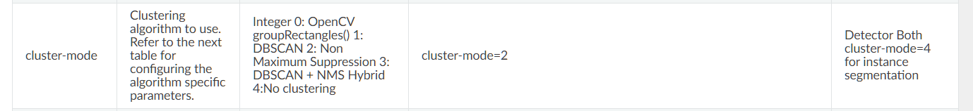

My model does very well in inference using the aggregate_cov model, but poorly using the mean_cov model. I’m trying to replicate these parameters in the deepstream spec sheets, but I’m not able to achieve the same results. My labels file is also set up the same way in the example.
@Hutch,
Firstly, please refer to https://github.com/NVIDIA-AI-IOT/deepstream_tlt_apps/blob/master/pgie_detectnet_v2_tlt_config.txt. Suggest using that tempalate for reference.
For example, set uff-input-dims, uff-input-blob-name, etc.
And retry again.
Second,
To narrow down whether it is an issue in DS, you can use the default detectnet_v2 jupyter notebook to train a model against default KITTI dataset. And deploy it in DS.
Hi morgan, does Deepstream uses Aggregate or Mean cov to draw bounding boxes?
what do Aggregate and Mean cov mean?
DeepStream is using OSD (VIC or CPU) to draw bbox on image.
I meant the bbox confidences on inference in Transfer Learning Toolkit , to make it clear to you, for example i have trained my model and inference it with aggregate_cov parameter and 0.9 threshold value in TLT it perfectly detected objects and draw bounding boxes but when i deploy it to Deepstream there is no bounding boxes until i was reduce the threshold to the 0.1.
I would ask this question as another topic after a while I think its clear that deepstream uses mean_cov or similar thing while thresholding bounding boxes, so if my quess is wrong, please let me know. Thank you
it depends on which cluster-mode you are using. TLT is using DBSCAN
By default, DeepStream is using OpenCV groupRectangles() with cluster-mode=0. For groupRectangles(), it’s good to set to 0.1
You could try DBSCAN in DeepStream with the same threshold - 0.9 as you used in TLT
https://docs.nvidia.com/metropolis/deepstream/dev-guide/text/DS_plugin_gst-nvinfer.html
I’m having the same issue: using the default jupyter notebook and kitti dataset my tlt-infer works great, but the deepstream detection is very poor. See this post Can't get TLT trained model get to work on Deepstream - Jetson (NX) - #2 by kayccc. Tried the decectnet config file, tried all possible eps, dbscan settings. And yes, I converted it on the xavier nx.
