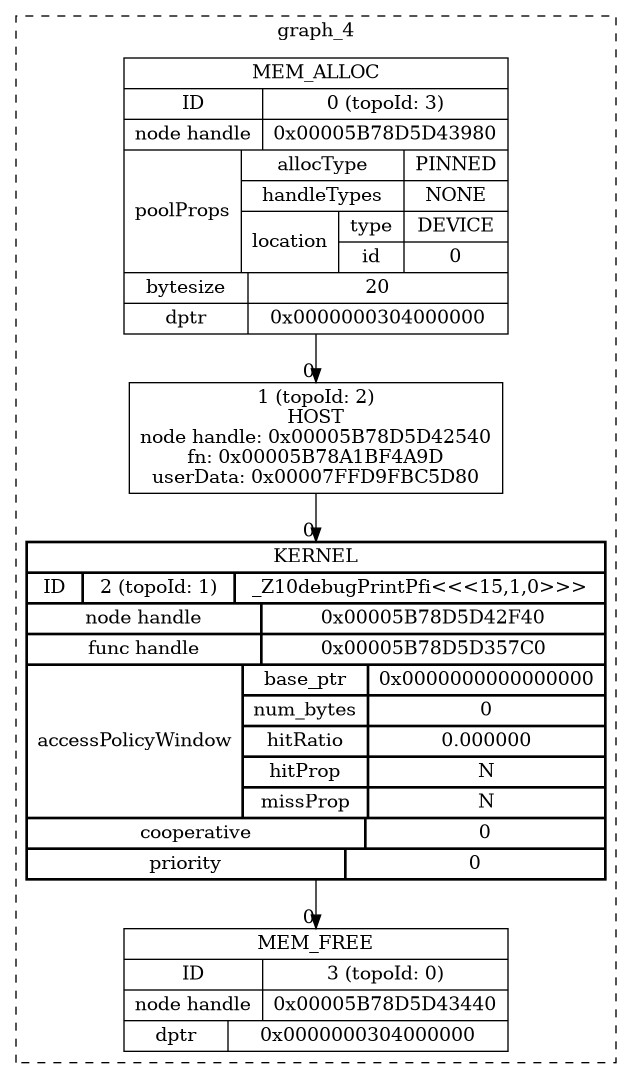

I am expecting to see 84 in the data_out as the host_set node should change the values. Instead it seems that the data copied to the device is of the first initialization therefore before the host_node function is executed.
I tried comparing the pointers but all seems to be consistent.
Also compute-sanitizer reports no issue.
Am I doing something wrong?
The topology looks correct. Have you tried creating the graph with stream capture?
Good idea! Unfortunately though I still get the same result…

  cudaGraphDebugDotPrint(graph, "graph.dot",
                         cudaGraphDebugDotFlags::cudaGraphDebugDotFlagsVerbose);

Also on top of it the stream capture does the mem copies but they are not shown in the debug dot print… As you can see in the graphs I attached.
Manually created graph
Graph created with stream capture
The programming guide states:
3.2.8.7.7.1.1. Device Graph Requirements
Memcpy nodes:
  • Only copies involving device memory and/or pinned device-mapped host memory are permitted.
Your usage of std::array does not constitute pinned device-mapped host memory. The following adaptation of your code seems to give the correct result for me:

Thank you Robert for clarifying it. I also noticed in the memcpy debug graph there you can see that it expects the host memory to be pageable. So maybe even though it is not documented that is what is expected.
Pageable is the opposite of pinned=page-locked!
exactly my point. I think there is an error even in the debug graph. In the debug graph you would expect the memcopy to happen after the host code from a not pinned memory. But that doesnt seem to be the case.
