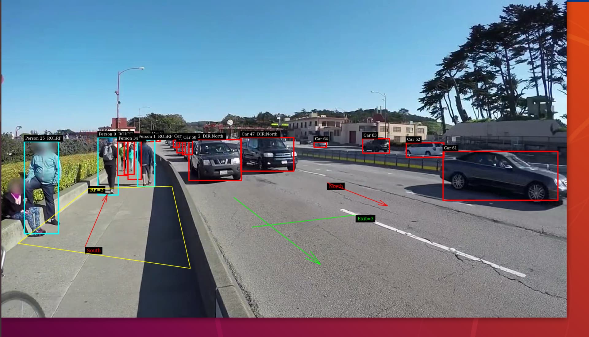

In deepstream-nvdsanalytics-test sample app the ObjectID is not shown as integer in display text, instead it is shown as different format.
for Example : Instead of showing
ObjectID 0
ObjectID 1
ObjectID 2,…
it shown as
ObjectID 164864131547875.
Im unable to find the exact source for this to change the datatype for ObjectID. How can I get it changed to simple ObjectID 0
ObjectID 1
ObjectID 2,…
Attached the screenshot of the output for the reference:
Screenshot at 2021-12-07 15-26-14
Kindly please help me out to get solution
Please find the config_tracker.yml file you are using and check the value of “useUniqueID” in the file. When “useUniqueID” is 0, the track id start from 0.
Defaultly it should be /opt/nvidia/deepstream/deepstream/samples/configs/deepstream-app/config_tracker_NvDCF_perf.yml

useUniqueID is already 0 by default, but still the output is mentioned above
There is a tracker.yml file in the location that you mentioned and also inside the deepstream-nvdsanalytics-test folder
useUniqueID : 0 in both the files, but the result is same
I’ve tried the default deepstream-nvdsanalytics-app on my platform, the trackid start from 0.
Please check what you have changed.

There is some error in /opt/nvidia/deepstream/deepstream-5.1/sources/apps/sample_apps/deepstream-nvdsanalytics-test/tracker_config.yml
Please use the config file /opt/nvidia/deepstream/deepstream-5.1/samples/configs/deepstream-app/tracker_config.yml
@Fiona.Chen Ok will check and update you
@Fiona.Chen After changing the yml file it is working.
