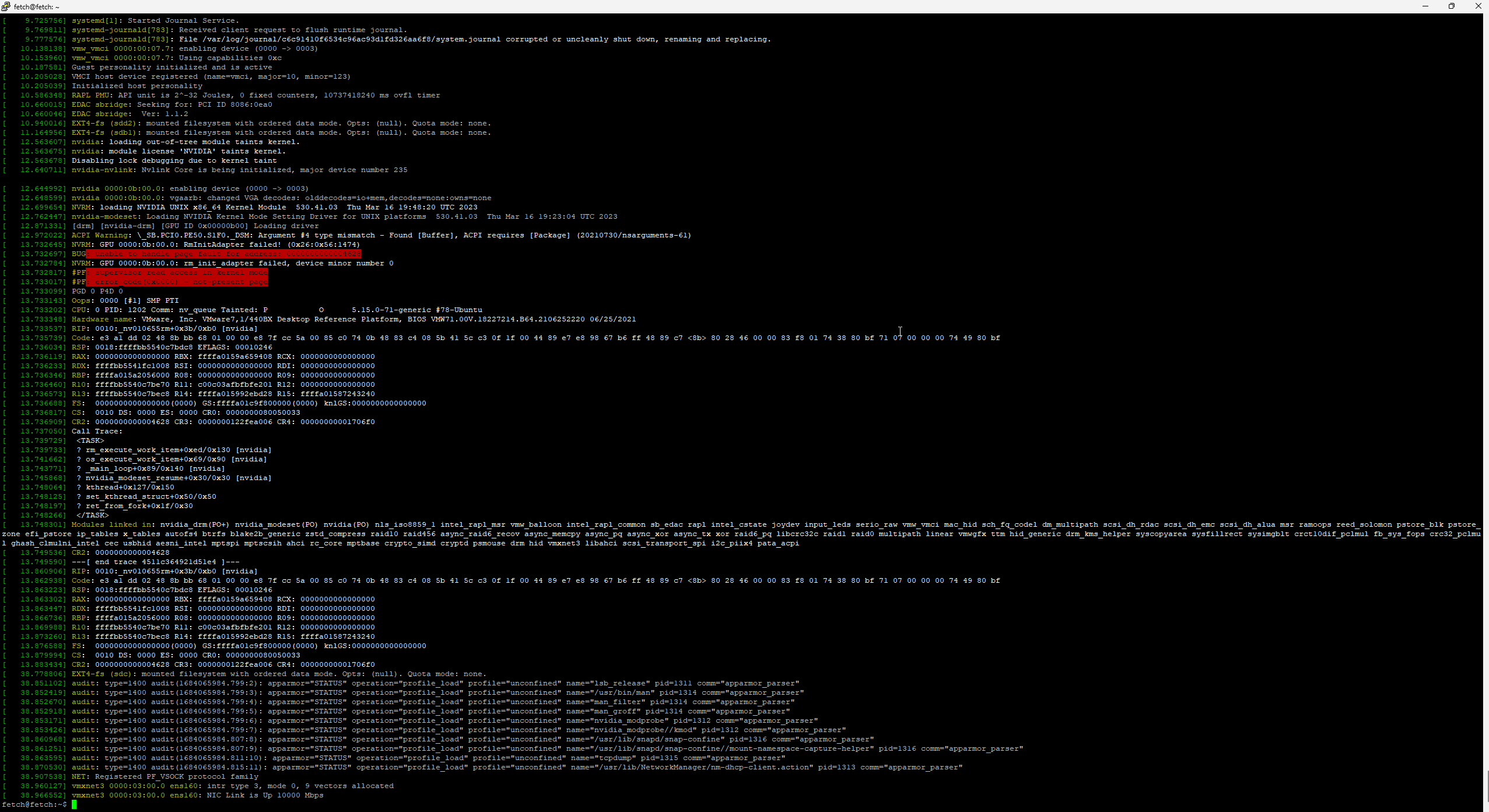

SOLVED - RmInitAdapter failed! to load 530.41.03 (or any nvidia modules other than 450.236.01) Linux via ESXi 7.0u3 Passthrough PCI GTX 1650
This was solved! See 2nd post for solution.
Running ESXi 7.0u3 on Dell PowerEdge T320
EFI Secure Boot (Still occurs with unsigned modules and secure boot DISABLED. Also occurs in BIOS mode vs EFI.)
Ubuntu Server 22.04
NVIDIA GTX 1650
Guest OS: 20 CPU Cores, 32GB RAM
nvidia-bug-report crashes the system so I’ve put what I can below.
I was only able to get the following driver to work at all: nvidia-srv-450.236.01 (provided by ubuntu nvidia-driver-450-server)
I have tried at least every one of these drivers:

nvidia-driver-450-server is the only working one.
Using any other driver from ubuntu or directly from NVIDIA causes things like RmInitAdapter failed! and the issues below. Problems occur regardless of modprobe config or VM advanced config options.
VM Advanced Options
hypervisor.cpuid.v0 = FALSE
pciPassthru0.msiEnabled = FALSE
Attempting to load any other driver than the 450 branch causes the following types of errors in dmesg and causes the system (both guest and host) to hang.
main dmesg error using 530.41.03

[   13.732645] NVRM: GPU 0000:0b:00.0: RmInitAdapter failed! (0x26:0x56:1474)
[   13.732697] BUG: unable to handle page fault for address: 0000000000004628
[   13.732784] NVRM: GPU 0000:0b:00.0: rm_init_adapter failed, device minor number 0
[   13.732817] #PF: supervisor read access in kernel mode
[   13.733017] #PF: error_code(0x0000) - not-present page
[   13.733099] PGD 0 P4D 0
[   13.733143] Oops: 0000 [#1] SMP PTI
[   13.733202] CPU: 0 PID: 1202 Comm: nv_queue Tainted: P           O      5.15.0-71-generic #78-Ubuntu
[   13.733348] Hardware name: VMware, Inc. VMware7,1/440BX Desktop Reference Platform, BIOS VMW71.00V.18227214.B64.2106252220 06/25/2021
[   13.733537] RIP: 0010:_nv010655rm+0x3b/0xb0 [nvidia]

[    1.004863] pci 0000:00:18.0:   bridge window [mem 0xfc700000-0xfc7fffff]
[    1.004967] pci 0000:00:18.0:   bridge window [mem 0xf0c00000-0xf0cfffff 64bit pref]
[    1.005854] pci 0000:00:18.1: PCI bridge to [bus 1c]
[    1.005959] pci 0000:00:18.1:   bridge window [mem 0xfc600000-0xfc6fffff]
[    1.006063] pci 0000:00:18.1:   bridge window [mem 0xf0b00000-0xf0bfffff 64bit pref]
[    1.006955] pci 0000:00:18.2: PCI bridge to [bus 1d]
[    1.007127] pci 0000:00:18.2:   bridge window [mem 0xfc500000-0xfc5fffff]
[    1.007233] pci 0000:00:18.2:   bridge window [mem 0xf0a00000-0xf0afffff 64bit pref]
[    1.008105] pci 0000:00:18.3: PCI bridge to [bus 1e]
[    1.008210] pci 0000:00:18.3:   bridge window [mem 0xfc400000-0xfc4fffff]
[    1.008314] pci 0000:00:18.3:   bridge window [mem 0xf0900000-0xf09fffff 64bit pref]
[    1.009487] pci 0000:00:18.4: PCI bridge to [bus 1f]
[    1.009593] pci 0000:00:18.4:   bridge window [mem 0xfc300000-0xfc3fffff]
[    1.009697] pci 0000:00:18.4:   bridge window [mem 0xf0800000-0xf08fffff 64bit pref]
[    1.010529] pci 0000:00:18.5: PCI bridge to [bus 20]
[    1.010635] pci 0000:00:18.5:   bridge window [mem 0xfc200000-0xfc2fffff]
[    1.010739] pci 0000:00:18.5:   bridge window [mem 0xf0700000-0xf07fffff 64bit pref]
[    1.011611] pci 0000:00:18.6: PCI bridge to [bus 21]
[    1.011716] pci 0000:00:18.6:   bridge window [mem 0xfc100000-0xfc1fffff]
[    1.011820] pci 0000:00:18.6:   bridge window [mem 0xf0600000-0xf06fffff 64bit pref]
[    1.012649] pci 0000:00:18.7: PCI bridge to [bus 22]
[    1.012753] pci 0000:00:18.7:   bridge window [mem 0xfc000000-0xfc0fffff]
[    1.012857] pci 0000:00:18.7:   bridge window [mem 0xf0500000-0xf05fffff 64bit pref]
[    1.018454] ACPI: PCI: Interrupt link LNKA configured for IRQ 0
[    1.018463] ACPI: PCI: Interrupt link LNKA disabled
[    1.019107] ACPI: PCI: Interrupt link LNKB configured for IRQ 0
[    1.019115] ACPI: PCI: Interrupt link LNKB disabled
[    1.019732] ACPI: PCI: Interrupt link LNKC configured for IRQ 0
[    1.019740] ACPI: PCI: Interrupt link LNKC disabled
[    1.020353] ACPI: PCI: Interrupt link LNKD configured for IRQ 0
[    1.020361] ACPI: PCI: Interrupt link LNKD disabled
[    1.102539] iommu: Default domain type: Translated
[    1.102547] iommu: DMA domain TLB invalidation policy: lazy mode
[    1.103581] SCSI subsystem initialized
[    1.103703] libata version 3.00 loaded.
[    1.103703] pci 0000:00:0f.0: vgaarb: setting as boot VGA device
[    1.103703] pci 0000:00:0f.0: vgaarb: VGA device added: decodes=io+mem,owns=io+mem,locks=none
[    1.103703] pci 0000:0b:00.0: vgaarb: VGA device added: decodes=io+mem,owns=none,locks=none
[    1.103703] pci 0000:00:0f.0: vgaarb: no bridge control possible
[    1.103703] pci 0000:0b:00.0: vgaarb: bridge control possible
[    1.103703] vgaarb: loaded
[    1.103703] ACPI: bus type USB registered
[    1.103703] usbcore: registered new interface driver usbfs
[    1.103703] usbcore: registered new interface driver hub
[    1.103703] usbcore: registered new device driver usb
[    1.103703] pps_core: LinuxPPS API ver. 1 registered
[    1.103703] pps_core: Software ver. 5.3.6 - Copyright 2005-2007 Rodolfo Giometti <giometti@linux.it>
[    1.103703] PTP clock support registered
[    1.103703] EDAC MC: Ver: 3.0.0
[    1.108225] Registered efivars operations
[    1.108225] NetLabel: Initializing
[    1.108225] NetLabel:  domain hash size = 128
[    1.108225] NetLabel:  protocols = UNLABELED CIPSOv4 CALIPSO
[    1.108225] NetLabel:  unlabeled traffic allowed by default
[    1.108225] PCI: Using ACPI for IRQ routing
[    1.123876] PCI: pci_cache_line_size set to 64 bytes
[    1.126225] e820: reserve RAM buffer [mem 0x0e402018-0x0fffffff]
[    1.126243] e820: reserve RAM buffer [mem 0x0e404018-0x0fffffff]
[    1.126256] e820: reserve RAM buffer [mem 0x0e407018-0x0fffffff]
[    1.126269] e820: reserve RAM buffer [mem 0x0e40a018-0x0fffffff]
[    1.126281] e820: reserve RAM buffer [mem 0x0efb0000-0x0fffffff]
[    1.126292] e820: reserve RAM buffer [mem 0x0efc2000-0x0fffffff]
[    1.126303] e820: reserve RAM buffer [mem 0x0fee6000-0x0fffffff]
[    1.127041] hpet0: at MMIO 0xfed00000, IRQs 2, 8, 0, 0, 0, 0, 0, 0, 0, 0, 0, 0, 0, 0, 0, 0
[    1.127124] hpet0: 16 comparators, 64-bit 14.318180 MHz counter
[    1.132981] clocksource: Switched to clocksource tsc-early
[    1.191560] VFS: Disk quotas dquot_6.6.0
[    1.191663] VFS: Dquot-cache hash table entries: 512 (order 0, 4096 bytes)
[    1.192236] AppArmor: AppArmor Filesystem Enabled
[    1.192315] pnp: PnP ACPI init
[    1.193227] pnp 00:00: disabling [io  0x0010-0x001f] because it overlaps 0000:00:07.7 BAR 0 [io  0x0000-0x003f]
[    1.193247] pnp 00:00: disabling [io  0x0024-0x0025] because it overlaps 0000:00:07.7 BAR 0 [io  0x0000-0x003f]
[    1.193264] pnp 00:00: disabling [io  0x0028-0x0029] because it overlaps 0000:00:07.7 BAR 0 [io  0x0000-0x003f]
[    1.193280] pnp 00:00: disabling [io  0x002c-0x002d] because it overlaps 0000:00:07.7 BAR 0 [io  0x0000-0x003f]
[    1.193296] pnp 00:00: disabling [io  0x002e-0x002f] because it overlaps 0000:00:07.7 BAR 0 [io  0x0000-0x003f]
[    1.193312] pnp 00:00: disabling [io  0x0030-0x0031] because it overlaps 0000:00:07.7 BAR 0 [io  0x0000-0x003f]
[    1.193328] pnp 00:00: disabling [io  0x0034-0x0035] because it overlaps 0000:00:07.7 BAR 0 [io  0x0000-0x003f]
[    1.193343] pnp 00:00: disabling [io  0x0038-0x0039] because it overlaps 0000:00:07.7 BAR 0 [io  0x0000-0x003f]
[    1.193359] pnp 00:00: disabling [io  0x003c-0x003d] because it overlaps 0000:00:07.7 BAR 0 [io  0x0000-0x003f]
[    1.193378] pnp 00:00: disabling [io  0x0000-0x000f] because it overlaps 0000:00:07.7 BAR 0 [io  0x0000-0x003f]
[    1.193648] system 00:00: [io  0x0440-0x047f] has been reserved
[    1.193664] system 00:00: [io  0x5658-0x5659] has been reserved
[    1.193678] system 00:00: [io  0x5670] has been reserved
[    1.193690] system 00:00: [io  0x0cf0-0x0cf1] has been reserved
[    1.195686] system 00:04: [mem 0xfed00000-0xfed003ff] has been reserved
[    1.213425] system 00:05: [io  0x0400-0x041f] has been reserved
[    1.213441] system 00:05: [mem 0xe0000000-0xe7ffffff] has been reserved
[    1.213457] system 00:05: [mem 0xffc00000-0xffdfffff] could not be reserved
[    1.229272] pnp: PnP ACPI: found 6 devices
[    1.245708] clocksource: acpi_pm: mask: 0xffffff max_cycles: 0xffffff, max_idle_ns: 2085701024 ns
[    1.246126] NET: Registered PF_INET protocol family
[    1.246705] IP idents hash table entries: 262144 (order: 9, 2097152 bytes, linear)
[    1.252007] tcp_listen_portaddr_hash hash table entries: 16384 (order: 6, 262144 bytes, linear)
[    1.252284] Table-perturb hash table entries: 65536 (order: 6, 262144 bytes, linear)
[    1.252740] TCP established hash table entries: 262144 (order: 9, 2097152 bytes, linear)
[    1.256589] TCP bind hash table entries: 65536 (order: 8, 1048576 bytes, linear)
[    1.257423] TCP: Hash tables configured (established 262144 bind 65536)
[    1.257952] MPTCP token hash table entries: 32768 (order: 7, 786432 bytes, linear)
[    1.258532] UDP hash table entries: 16384 (order: 7, 524288 bytes, linear)
[    1.259075] UDP-Lite hash table entries: 16384 (order: 7, 524288 bytes, linear)
[    1.259852] NET: Registered PF_UNIX/PF_LOCAL protocol family
[    1.259875] NET: Registered PF_XDP protocol family
[    1.259892] pci 0000:00:10.0: can't claim BAR 6 [mem 0xffffc000-0xffffffff pref]: no compatible bridge window
[    1.259911] pci 0000:02:03.0: can't claim BAR 6 [mem 0xffff0000-0xffffffff pref]: no compatible bridge window
[    1.259926] pci 0000:03:00.0: can't claim BAR 6 [mem 0xffff0000-0xffffffff pref]: no compatible bridge window
[    1.259967] pci 0000:00:15.0: bridge window [mem 0x00100000-0x000fffff 64bit pref] to [bus 03] add_size 200000 add_align 100000
[    1.259988] pci 0000:00:15.1: bridge window [io  0x1000-0x0fff] to [bus 04] add_size 1000
[    1.260005] pci 0000:00:15.2: bridge window [io  0x1000-0x0fff] to [bus 05] add_size 1000
[    1.260020] pci 0000:00:15.3: bridge window [io  0x1000-0x0fff] to [bus 06] add_size 1000
[    1.260036] pci 0000:00:15.4: bridge window [io  0x1000-0x0fff] to [bus 07] add_size 1000
[    1.260052] pci 0000:00:15.5: bridge window [io  0x1000-0x0fff] to [bus 08] add_size 1000
[    1.260067] pci 0000:00:15.6: bridge window [io  0x1000-0x0fff] to [bus 09] add_size 1000
[    1.260083] pci 0000:00:15.7: bridge window [io  0x1000-0x0fff] to [bus 0a] add_size 1000
[    1.260100] pci 0000:00:16.1: bridge window [io  0x1000-0x0fff] to [bus 0c] add_size 1000
[    1.260115] pci 0000:00:16.2: bridge window [io  0x1000-0x0fff] to [bus 0d] add_size 1000
[    1.260131] pci 0000:00:16.3: bridge window [io  0x1000-0x0fff] to [bus 0e] add_size 1000
[    1.260146] pci 0000:00:16.4: bridge window [io  0x1000-0x0fff] to [bus 0f] add_size 1000
[    1.260162] pci 0000:00:16.5: bridge window [io  0x1000-0x0fff] to [bus 10] add_size 1000
[    1.260178] pci 0000:00:16.6: bridge window [io  0x1000-0x0fff] to [bus 11] add_size 1000
[    1.260193] pci 0000:00:16.7: bridge window [io  0x1000-0x0fff] to [bus 12] add_size 1000
[    1.260209] pci 0000:00:17.0: bridge window [io  0x1000-0x0fff] to [bus 13] add_size 1000
[    1.260225] pci 0000:00:17.1: bridge window [io  0x1000-0x0fff] to [bus 14] add_size 1000
[    1.260241] pci 0000:00:17.2: bridge window [io  0x1000-0x0fff] to [bus 15] add_size 1000
[    1.260256] pci 0000:00:17.3: bridge window [io  0x1000-0x0fff] to [bus 16] add_size 1000
[    1.260272] pci 0000:00:17.4: bridge window [io  0x1000-0x0fff] to [bus 17] add_size 1000
[    1.260288] pci 0000:00:17.5: bridge window [io  0x1000-0x0fff] to [bus 18] add_size 1000
[    1.260303] pci 0000:00:17.6: bridge window [io  0x1000-0x0fff] to [bus 19] add_size 1000
[    1.260319] pci 0000:00:17.7: bridge window [io  0x1000-0x0fff] to [bus 1a] add_size 1000
[    1.260335] pci 0000:00:18.0: bridge window [io  0x1000-0x0fff] to [bus 1b] add_size 1000
[    1.260351] pci 0000:00:18.1: bridge window [io  0x1000-0x0fff] to [bus 1c] add_size 1000
[    1.260366] pci 0000:00:18.2: bridge window [io  0x1000-0x0fff] to [bus 1d] add_size 1000
[    1.260382] pci 0000:00:18.3: bridge window [io  0x1000-0x0fff] to [bus 1e] add_size 1000
[    1.260398] pci 0000:00:18.4: bridge window [io  0x1000-0x0fff] to [bus 1f] add_size 1000
[    1.260414] pci 0000:00:18.5: bridge window [io  0x1000-0x0fff] to [bus 20] add_size 1000
[    1.260429] pci 0000:00:18.6: bridge window [io  0x1000-0x0fff] to [bus 21] add_size 1000
[    1.260445] pci 0000:00:18.7: bridge window [io  0x1000-0x0fff] to [bus 22] add_size 1000
[    1.260576] clipped [mem size 0x00000000 64bit pref] to [mem size 0xfffffffffffc4000 64bit pref] for e820 entry [mem 0x000c0000-0x000fffff]
[    1.260596] clipped [mem size 0x00000000 64bit pref] to [mem size 0xfffffffffffd4000 64bit pref] for e820 entry [mem 0x000c0000-0x000fffff]
[    1.260613] clipped [mem size 0x00000000 64bit pref] to [mem size 0xfffffffffffe4000 64bit pref] for e820 entry [mem 0x000c0000-0x000fffff]
[    1.260647] clipped [mem size 0x00008000 64bit pref] to [mem size 0xfffffffffffcc000 64bit pref] for e820 entry [mem 0x000c0000-0x000fffff]
[    1.260665] clipped [mem size 0x00008000 64bit pref] to [mem size 0xfffffffffffdc000 64bit pref] for e820 entry [mem 0x000c0000-0x000fffff]
[    1.260682] clipped [mem size 0x0000c000 64bit pref] to [mem size 0xffffffffffff0000 64bit pref] for e820 entry [mem 0x000c0000-0x000fffff]
[    1.260702] pci 0000:00:15.0: BAR 15: assigned [mem 0xd2000000-0xd21fffff 64bit pref]
[    1.260723] clipped [mem size 0x00008000 pref] to [mem size 0xfffffffffffcc000 pref] for e820 entry [mem 0x000c0000-0x000fffff]
[    1.260740] clipped [mem size 0x00008000 pref] to [mem size 0xfffffffffffdc000 pref] for e820 entry [mem 0x000c0000-0x000fffff]
[    1.260757] clipped [mem size 0x0000c000 pref] to [mem size 0xffffffffffff0000 pref] for e820 entry [mem 0x000c0000-0x000fffff]
[    1.260776] pci 0000:00:10.0: BAR 6: assigned [mem 0xd2200000-0xd2203fff pref]
[    1.260795] clipped [mem size 0x00000000 64bit] to [mem size 0xfffffffffffc4000 64bit] for e820 entry [mem 0x000c0000-0x000fffff]
[    1.260812] clipped [mem size 0x00000000 64bit] to [mem size 0xfffffffffffd4000 64bit] for e820 entry [mem 0x000c0000-0x000fffff]
[    1.260828] clipped [mem size 0x00000000 64bit] to [mem size 0xfffffffffffe4000 64bit] for e820 entry [mem 0x000c0000-0x000fffff]
[    1.260859] clipped [mem size 0x00008000 64bit] to [mem size 0xfffffffffffcc000 64bit] for e820 entry [mem 0x000c0000-0x000fffff]
[    1.260875] clipped [mem size 0x00008000 64bit] to [mem size 0xfffffffffffdc000 64bit] for e820 entry [mem 0x000c0000-0x000fffff]
[    1.260892] clipped [mem size 0x0000c000 64bit] to [mem size 0xffffffffffff0000 64bit] for e820 entry [mem 0x000c0000-0x000fffff]
[    1.260911] pci 0000:00:07.7: BAR 1: assigned [mem 0xd2204000-0xd2205fff 64bit]
[    1.261133] pci 0000:00:15.1: BAR 13: assigned [io  0x6000-0x6fff]
[    1.261151] pci 0000:00:15.2: BAR 13: assigned [io  0x7000-0x7fff]
[    1.261168] pci 0000:00:15.3: BAR 13: assigned [io  0x8000-0x8fff]
[    1.261185] pci 0000:00:15.4: BAR 13: assigned [io  0x9000-0x9fff]
[    1.261203] pci 0000:00:15.5: BAR 13: assigned [io  0xa000-0xafff]
[    1.261220] pci 0000:00:15.6: BAR 13: assigned [io  0xb000-0xbfff]
[    1.261237] pci 0000:00:15.7: BAR 13: assigned [io  0xc000-0xcfff]
[    1.261254] pci 0000:00:16.1: BAR 13: assigned [io  0xd000-0xdfff]
[    1.261271] pci 0000:00:16.2: BAR 13: assigned [io  0xe000-0xefff]
[    1.261288] pci 0000:00:16.3: BAR 13: assigned [io  0xf000-0xffff]
[    1.261307] pci 0000:00:16.4: BAR 13: no space for [io  size 0x1000]
[    1.261320] pci 0000:00:16.4: BAR 13: failed to assign [io  size 0x1000]
[    1.261339] pci 0000:00:16.5: BAR 13: no space for [io  size 0x1000]
[    1.261351] pci 0000:00:16.5: BAR 13: failed to assign [io  size 0x1000]
[    1.261370] pci 0000:00:16.6: BAR 13: no space for [io  size 0x1000]
[    1.261382] pci 0000:00:16.6: BAR 13: failed to assign [io  size 0x1000]
[    1.261401] pci 0000:00:16.7: BAR 13: no space for [io  size 0x1000]
[    1.261413] pci 0000:00:16.7: BAR 13: failed to assign [io  size 0x1000]
[    1.261432] pci 0000:00:17.0: BAR 13: no space for [io  size 0x1000]
[    1.261444] pci 0000:00:17.0: BAR 13: failed to assign [io  size 0x1000]
[    1.261462] pci 0000:00:17.1: BAR 13: no space for [io  size 0x1000]

[   12.563607] nvidia: loading out-of-tree module taints kernel.
[   12.563675] nvidia: module license 'NVIDIA' taints kernel.
[   12.563678] Disabling lock debugging due to kernel taint
[   12.640711] nvidia-nvlink: Nvlink Core is being initialized, major device number 235
[   12.644992] nvidia 0000:0b:00.0: enabling device (0000 -> 0003)
[   12.648599] nvidia 0000:0b:00.0: vgaarb: changed VGA decodes: olddecodes=io+mem,decodes=none:owns=none
[   12.699654] NVRM: loading NVIDIA UNIX x86_64 Kernel Module  530.41.03  Thu Mar 16 19:48:20 UTC 2023
[   12.762447] nvidia-modeset: Loading NVIDIA Kernel Mode Setting Driver for UNIX platforms  530.41.03  Thu Mar 16 19:23:04 UTC 2023
[   12.871331] [drm] [nvidia-drm] [GPU ID 0x00000b00] Loading driver
[   12.972022] ACPI Warning: \_SB.PCI0.PE50.S1F0._DSM: Argument #4 type mismatch - Found [Buffer], ACPI requires [Package] (20210730/nsarguments-61)
[   13.735739] Code: e3 a1 dd 02 48 8b bb 68 01 00 00 e8 7f cc 5a 00 85 c0 74 0b 48 83 c4 08 5b 41 5c c3 0f 1f 00 44 89 e7 e8 98 67 b6 ff 48 89 c7 <8b> 80 28 46 00 00 83 f8 01 74 38 80 bf 71 07 00 00 00 74 49 80 bf
[   13.736034] RSP: 0018:ffffbb5540c7bdc8 EFLAGS: 00010246
[   13.736119] RAX: 0000000000000000 RBX: ffffa0159a659408 RCX: 0000000000000000
[   13.736233] RDX: ffffbb5541fc1008 RSI: 0000000000000000 RDI: 0000000000000000
[   13.736346] RBP: ffffa015a2056000 R08: 0000000000000000 R09: 0000000000000000
[   13.736460] R10: ffffbb5540c7be70 R11: c00c03afbfbfe201 R12: 0000000000000000
[   13.736573] R13: ffffbb5540c7bec8 R14: ffffa015992ebd28 R15: ffffa01587243240
[   13.736688] FS:  0000000000000000(0000) GS:ffffa01c9f800000(0000) knlGS:0000000000000000
[   13.736817] CS:  0010 DS: 0000 ES: 0000 CR0: 0000000080050033
[   13.736909] CR2: 0000000000004628 CR3: 0000000122fea006 CR4: 00000000001706f0
[   13.737050] Call Trace:
[   13.739729]  <TASK>
[   13.739733]  ? rm_execute_work_item+0xed/0x130 [nvidia]
[   13.741662]  ? os_execute_work_item+0x69/0x90 [nvidia]
[   13.743771]  ? _main_loop+0x89/0x140 [nvidia]
[   13.745868]  ? nvidia_modeset_resume+0x30/0x30 [nvidia]
[   13.748064]  ? kthread+0x127/0x150
[   13.748125]  ? set_kthread_struct+0x50/0x50
[   13.748197]  ? ret_from_fork+0x1f/0x30
[   13.748266]  </TASK>
[   13.748301] Modules linked in: nvidia_drm(PO+) nvidia_modeset(PO) nvidia(PO) nls_iso8859_1 intel_rapl_msr vmw_balloon intel_rapl_common sb_edac rapl intel_cstate joydev input_leds serio_raw vmw_vmci mac_hid sch_fq_codel dm_multipath scsi_dh_rdac scsi_dh_emc scsi_dh_alua msr ramoops reed_solomon pstore_blk pstore_
zone efi_pstore ip_tables x_tables autofs4 btrfs blake2b_generic zstd_compress raid10 raid456 async_raid6_recov async_memcpy async_pq async_xor async_tx xor raid6_pq libcrc32c raid1 raid0 multipath linear vmwgfx ttm hid_generic drm_kms_helper syscopyarea sysfillrect sysimgblt crct10dif_pclmul fb_sys_fops crc32_pclmu
l ghash_clmulni_intel cec usbhid aesni_intel mptspi mptscsih ahci rc_core mptbase crypto_simd cryptd psmouse drm hid vmxnet3 libahci scsi_transport_spi i2c_piix4 pata_acpi
[   13.749536] CR2: 0000000000004628
[   13.749590] ---[ end trace 4511c364921d51e4 ]---
[   13.860906] RIP: 0010:_nv010655rm+0x3b/0xb0 [nvidia]
[   13.862938] Code: e3 a1 dd 02 48 8b bb 68 01 00 00 e8 7f cc 5a 00 85 c0 74 0b 48 83 c4 08 5b 41 5c c3 0f 1f 00 44 89 e7 e8 98 67 b6 ff 48 89 c7 <8b> 80 28 46 00 00 83 f8 01 74 38 80 bf 71 07 00 00 00 74 49 80 bf
[   13.863223] RSP: 0018:ffffbb5540c7bdc8 EFLAGS: 00010246
[   13.863302] RAX: 0000000000000000 RBX: ffffa0159a659408 RCX: 0000000000000000
[   13.863447] RDX: ffffbb5541fc1008 RSI: 0000000000000000 RDI: 0000000000000000
[   13.866736] RBP: ffffa015a2056000 R08: 0000000000000000 R09: 0000000000000000
[   13.869988] R10: ffffbb5540c7be70 R11: c00c03afbfbfe201 R12: 0000000000000000
[   13.873260] R13: ffffbb5540c7bec8 R14: ffffa015992ebd28 R15: ffffa01587243240
[   13.876588] FS:  0000000000000000(0000) GS:ffffa01c9f800000(0000) knlGS:0000000000000000
[   13.879994] CS:  0010 DS: 0000 ES: 0000 CR0: 0000000080050033
[   13.883434] CR2: 0000000000004628 CR3: 0000000122fea006 CR4: 00000000001706f0
[   38.778806] EXT4-fs (sdc): mounted filesystem with ordered data mode. Opts: (null). Quota mode: none.
[   38.851102] audit: type=1400 audit(1684065984.799:2): apparmor="STATUS" operation="profile_load" profile="unconfined" name="lsb_release" pid=1311 comm="apparmor_parser"
[   38.852419] audit: type=1400 audit(1684065984.799:3): apparmor="STATUS" operation="profile_load" profile="unconfined" name="/usr/bin/man" pid=1314 comm="apparmor_parser"
[   38.852670] audit: type=1400 audit(1684065984.799:4): apparmor="STATUS" operation="profile_load" profile="unconfined" name="man_filter" pid=1314 comm="apparmor_parser"
[   38.852918] audit: type=1400 audit(1684065984.799:5): apparmor="STATUS" operation="profile_load" profile="unconfined" name="man_groff" pid=1314 comm="apparmor_parser"
[   38.853171] audit: type=1400 audit(1684065984.799:6): apparmor="STATUS" operation="profile_load" profile="unconfined" name="nvidia_modprobe" pid=1312 comm="apparmor_parser"
[   38.853426] audit: type=1400 audit(1684065984.799:7): apparmor="STATUS" operation="profile_load" profile="unconfined" name="nvidia_modprobe//kmod" pid=1312 comm="apparmor_parser"
[   38.860968] audit: type=1400 audit(1684065984.807:8): apparmor="STATUS" operation="profile_load" profile="unconfined" name="/usr/lib/snapd/snap-confine" pid=1316 comm="apparmor_parser"
[   38.861251] audit: type=1400 audit(1684065984.807:9): apparmor="STATUS" operation="profile_load" profile="unconfined" name="/usr/lib/snapd/snap-confine//mount-namespace-capture-helper" pid=1316 comm="apparmor_parser"
[   38.863595] audit: type=1400 audit(1684065984.811:10): apparmor="STATUS" operation="profile_load" profile="unconfined" name="tcpdump" pid=1315 comm="apparmor_parser"
[   38.870530] audit: type=1400 audit(1684065984.815:11): apparmor="STATUS" operation="profile_load" profile="unconfined" name="/usr/lib/NetworkManager/nm-dhcp-client.action" pid=1313 comm="apparmor_parser"
[   38.907538] NET: Registered PF_VSOCK protocol family
[   38.960127] vmxnet3 0000:03:00.0 ens160: intr type 3, mode 0, 9 vectors allocated
[   38.966552] vmxnet3 0000:03:00.0 ens160: NIC Link is Up 10000 Mbps

dmesg and console error screenshots
ESXi PCI
