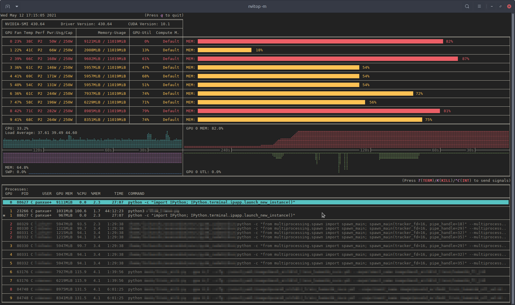

Try out nvitop, a monitor based on NVML Python bindings nvidia-ml-py:
On Linux:
On Windows:
Tree-view:
