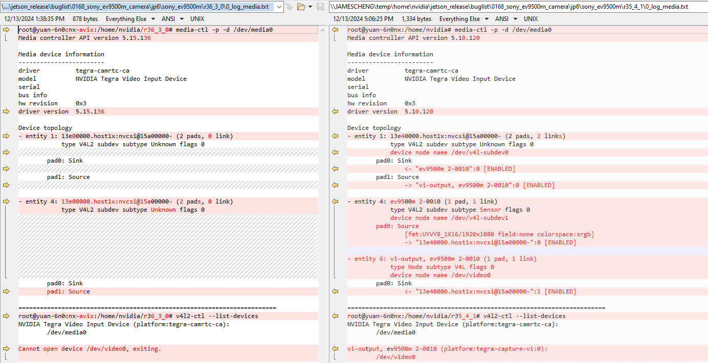

I use meia-ctl -p -d /dev/media0 to get the topology of media0. It loooks like the device tree is not correct, and pads don’t create correctly when the L4T is 36.3.0

re-cap the kernel logs, it looks camera driver probing has done.
[   11.771082] ev9500m 2-0010: tegracam sensor driver:ev9500m_v2.0.6
[   11.771086] ev9500m 2-0010: ev9500m_board_setup:540
[   11.771089] ev9500m 2-0010: ev9500m_power_on:378
[   11.771092] ev9500m 2-0010: ev9500m_power_on:470
[   11.771110] ev9500m 2-0010: detected ev9500m sensor
here’re erroneous of NVCSI and VI,

you must have correct port bindings for Sensor/NVCSI/VI.
please revise the NVCSI and VI port bindings as… bus-width = <4>; and port-index = <0>; since it’s a 4-lane camera for using CSI-A.
I check the tegra234-camera-mp740n2_r3630_ev9500m_n1.dtsi, the settings of bus-width and port-index are correct. But they are not correct of export device tree. If I modify the bus-width and port-index of overlay/tegra234-camera-rbpcv2-imx219.dtsi, these two properties are correct of the export device tree, but video device is still not created.
