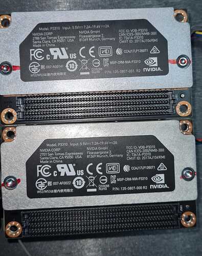

Disabling panic on hung task just leaves the system locked. As mentioned, after rebooting the system makes it continue fine for another 50-80 boot loops.
Do you have any suggestions for some kernel fixes I could try? Thank you
Got about 6 boards running the same boot test and am seeing the same sporadic failures. Looks rather like a BSP related race-condition more than filesystem corruption, because rebooting the board once more works without problems.
I’ve backported all mmc and ext4 patches from L4T 32.5.1 to L4T 32.4.4:

Any suggestion for other patches I could check? Thanks
Update: I’m seeing this on another board with L4T 32.5.1 too.
You should tell more about the board. For example, is it a custom board or devkit? How many modules have this issue?

Hi @WayneWWW , I’m seeing this with 2 Devkits, one CTI Orbitty and one Auvidea J120. All 4 modules are using the same devkit image and same devkit device-tree.
Can you share the sticker of those tx2 modules?
Sure @WayneWWW , these are the stickers:
Are there modules TX2 D02? D01? C03? or something else?
Are you referring to the sticker near the antennas @WayneWWW ? If so they are: D00 H, B02 F, D01 B, B02 C.
